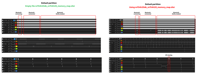

How I detect the SPI delay (logic analyzer + test points)
The attached logic analyzer screenshot was captured with the following instrumentation around the SPIS spi_transceive() call:
On the logic analyzer:
  • TP3 shows when the SPIS driver is inside spi_transceive().
  • TP0 shows the post‑processing of the received SPI frame.
  • TP1 is only asserted when the 16‑bit counter in the payload is not consecutive, indicating that a frame was delayed or lost.
After switching to the new partitioning scheme (aligned with single‑slot DFU) but with MCUboot still disabled, the TP3 window becomes noticeably longer between the master asserting CS/SCK and the SPIS transaction completing, which matches the observed read delay on nRF54H20.
