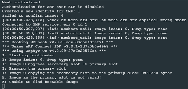

    The Issue:
    When we transfer build_1 (v1.0.1) via BLE DFU onto a device currently running build (v1.0.0), the boot fails.
    Crucially, we have verified that if we perform a full Erase & Flash using the .hex file from build_1, the application boots and runs perfectly fine.
    This proves that the image itself is not corrupted, and the failure resides entirely within the DFU/decompression mechanism under the DTS configuration.

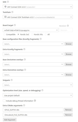

    How to Build:
    If you choose to rebuild the project, you must set FILE_SUFFIX=dts for both the application and MCUboot.
    Please refer to our Build Configuration example below:

  •  I ran your project. Did you get the same error log after updating the package? Since you only mention that the DFU update failed without a log, I need to confirm that we are seeing the same issue.

  • Did you get the same error log after updating the package?
    Yes, it is the exact same log.
