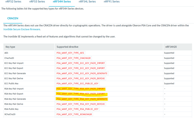

[00:00:13.662,061] <err> net_sock_tls: TLS handshake error: -0x2700
[00:00:13.686,503] <err> mqtt_helper: mqtt_connect, error: -113
[00:00:13.695,376] <err> azure_iot_hub_dps: mqtt_helper_connect failed, error: -113
[00:00:13.707,476] <err> azure_task: DPS failed to start, error: -113
[00:00:13.716,836] <err> azure_task: Failed to run DPS, error: -113, terminating connection attempt
The error -0x2700 comes from modules/crypto/mbedtls/library/ssl_tlc.c where x509_verify_cert() return -9984 which gives the flag MBEDTLS_X509_BADCERT_NOT_TRUSTED
I know the certificate is good, since i used the exact same on the nrf7002dk
I have tried a multitude of different configs and debugging, but i cant see any problems.
All help would be greatly appreciated
