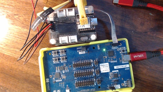

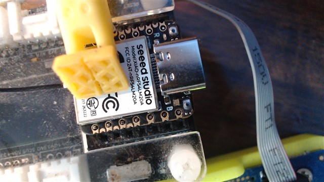

I have the XIAO nRF54LM20A mounted on the Seeed expansion board and connected by external SWD to the P19 external-debug port of an nRF54L15 DK. The nRF54L15 DK onboard J-Link connects to the LM20A reliably:

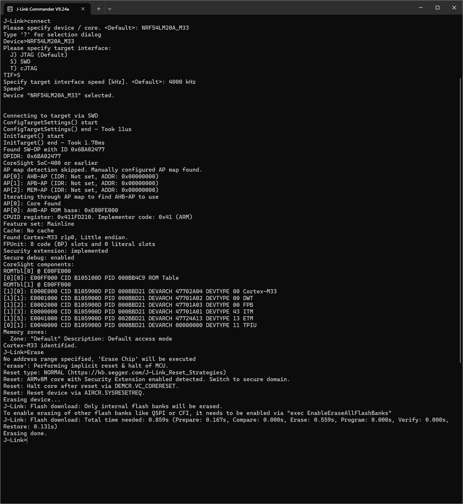

The issue is with direct J-Link Commander flash operations. I tested current J-Link software, including V9.30a, with the nRF54L15 DK onboard J-Link firmware dated July 8, 2025. J-Link Commander can connect and debug the LM20A, but both erase and loadfile fail with:
“Timeout while preparing target, RAMCode did not respond in time!”
“Failed to perform RAMCode-sided Prepare()”
This happens at 500 kHz SWD as well as 1 MHz. Because nrfutil programs the same target successfully through the same physical setup, the wiring, target power, SWD access, build artifact, and basic debugger path appear sound.

    As a first step, can you just confirm that the supply voltage on the DK is equal the voltage on your board. If not, you can open the nRF Connect for Desktop -> Board Configurator app and modify the voltage to fit your board.
    Reason for asking is that it seems to work here:
    Kenneth
  • Hi there,
    And thanks Kenneth, for the reply and check, both are 3.3v devices and the DK is set to that as well. The Flash will erase but , I believe its a Bank method being used for that, vs. the RRAM dac and using a READ or Writing command fails with the OB J-Link firmware. I think that it is probably not current enough to be aware of how the new largest RRam Flash on the planet is used is all I can figure , because the same hardware connections and settings Flash fine with NrfUtil commands 100% success. so the disconnect is the OB Jlink and Nordic code that reads/writes.
    hope they get it sorted or can say either way if it works or NOT ?
    GL :-) PJ :v:
  • Hi there,
    SO, turns OUT the OB firmware was the issue, Segger released J-Link commander V9.54 with a update for the nRF54L15DK , After update EVERYTHING works.
    I can Erase, Read, Write (loadfile), and Halt, and Debug the Xiao nRF54LM20A with the SWD and the P19 connector on the DK. Interesting enough the Nrf_programmer Now Lists the MCU correctly when connected to the DK external P19 port.
    Here is the J-Link Flow, and above are the connections.
    device nRF54LM20A_M33
    si SWD
    speed 500
    connect
    r
    h
    erase
    r
    h
    loadfile D:\Nordic\myapps\workspace\hello_world_2\build\merged.hex
    r
    g
    __ Proves to work reliably__
