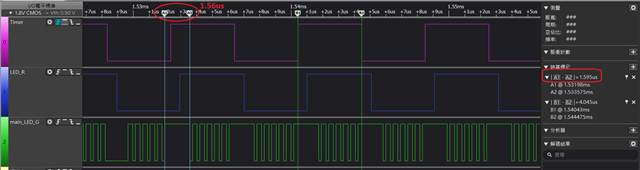

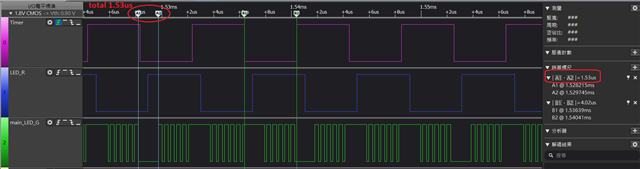

    When using 1. and remark 2., the result as below. The Timer 00 cost 1.53us .
    When using 2. remak 1., the result as below. The Timer 00 cost 1.595us .
    Do you have better way to reduce the cost?

  • Hi Austin,
    If you use GPIOs to measure the timing it is important that you use pins from the fast P2 port and that you use direct register access to set or clear the pin to minimise latency and jitter introduced by your measurement.
    #include <hal/nrf_gpio.h>
    nrf_gpio_cfg_output(NRF_GPIO_PIN_MAP(2, 9))
    // Code to clear P2.09
    NRF_P2->OUTCLR = (1 << 9);
    // Code to set P2.09
    NRF_P2->OUTSET = (1 << 9);
    Another alternative is to use the timing functions available in Zephyr and print the measured result out on UART: https://docs.zephyrproject.org/latest/kernel/timing_functions/index.html
