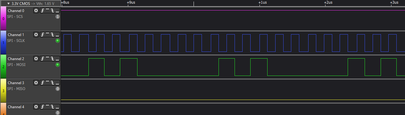

SPI Master - SCK, MOSI work but CS doesn't
I am using nRF54L15-DK board for development and currently I am trying to talk to an external module via SPI (nRF dev board is the master).
I have disabled the external flash memory from the nrf Connect for Desktop, set the pins voltage to 3.3V and as you can see the overlay I am trying to use P0.1 as a CS.
The problem is the CS that is seems being high all the time. I am providing my overlay below and parts of the spec structure configuration and the test code that I am running
in order to check the issue with a logic analyzer

Visual status via the logic analyzer, that shows the MOSI and SCK working fine but the CS line is always high. Note that I have tested the analyzers channel 0 and it works fine
Originally I tried using P2.5 as the CS but this didn't work, so that's why I've tried using P0.1 as CS but again I have the same issue. I am not sure what I am doing wrong, if it is some configuration issue or if I missed something important. Can anyone please advice me on this? I am using nRF Connect SDK v3.2.4. TIA
