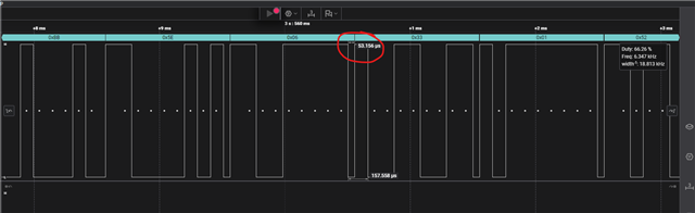

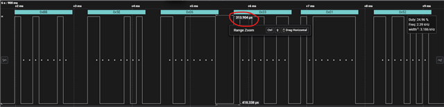

On our nRF‑based device at 9600 baud, each byte correctly takes ~1.04 ms.
However, the gap between bytes (idle time between stop bit of one byte and start bit of the next) changes drastically depending on context:
1. UART RX callback → UART TX
If we call our transmit function directly inside the UART RX callback (or a parser function invoked from it), the inter‑byte gap is only ~53 µs.
2. k_work_delayable handler → UART TX
If we schedule the exact same transmit function using k_work_schedule(), the inter‑byte gap increases to ~313 µs, and the target device (RS‑232 peer) accepts the frame reliably.
Nothing else changes; same bytes, same baud rate, same framing.
This difference in inter‑byte spacing is causing a downstream RS‑232 device (non‑Nordic) to fail to parse frames correctly unless TX happens from a workqueue instead of inside the RX callback.
I will attach logic analyzer screenshots showing both cases.

    Thanks for the clarification. There wasn’t any specific reason we were using uart_poll_out(). The original implementation just evolved that way. Based on your suggestion, we’ve now switched over to using uart_tx() to send the whole buffer at once, and now I see the correct timing on the logic analyzer capture.

    Thanks for your input. I understand what you are saying but if k_msleep(1) was called in the working case then the time gap between bytes would be at least 1 ms where as the logic analyzer shows a 313 µs time gap.
    Also in the failing case, if the UART functionality is entering a spin loop and busy wait until the TX is ready, it must wait at least ~104 µs to follow the 9600 baud rate. My theory is that the receiving device is not correctly processing my failing case UART because the time gap between bytes is not at least ~104 µs. Meaning the receiving device may not see that  ~53 µs gap resulting in failed UART decoding.
