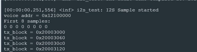

Then i tried to  store one pcm data, then read it and play it  to i2s, but the problem is when i store the array into external flash, there is no sound, and there is not any waves on the i2s-dout line, but if i store the array into internal flash, everything will be ok, sound is good.
When i stored the array into external flash, I have tried to read the data through "flash_read()" first, sound is also ok, but when i use memcpy, there is no sound. But i want to use XIP, so i can not use "flash_read()".
So i do not know what is the problem, the data stored in the external flash is unquestionably correct, as demonstrated by printing and the "flash_read" operation. However, it cannot be directly utilized when feeding data into I2S. Additionally, I have allocated an I2S buffer here and assigned the data to the buffer.
I noticed that there are "Errata 216" and "Errata 215", but i do not know the real problem of me, maybe other configurations fault(devicetree or kconfig), after all i can not find some example.

    I have looked at yoru code. First I run this and it shows normal output like I2S starts. Later I added few lines in the code to check if the array is linked into the XIP region 0x12100000  as it's in the code.
    printk("voice addr = %p\n", __48kHz16bit_mono_voice_smoke_pcm);
    const int16_t *p = (const int16_t *)__48kHz16bit_mono_voice_smoke_pcm;
    printk("First 8 samples:\n");
    for (int i = 0; i < 8; i++) {
        printk("%d ", p[i]);
    printk("\n");
    And prinktk in the TX data blocks to check I2S DMA buffer
    * Prepare TX data blocks */
    	for (tx_idx = 0; tx_idx < NUM_BLOCKS; tx_idx++) {
    		err = k_mem_slab_alloc(&tx_mem_slab, &tx_block[tx_idx], K_FOREVER);
    printk("tx_block = %p\n", tx_block[tx_idx]);
    		if(err) {
    			LOG_ERR("k_mem_slab_alloc() failed. (err %d)", err);
    			return err;
    The output shows good. The array is linked into the XIP region (0x12100000); no issue with that, I2S DMA buffers are in SRAM (ox2003xxx).
    But I need to find out why first 8 samples shows zero. I will try to print more samples to check if those are still zero even more into the file. I will get back to you soon.
