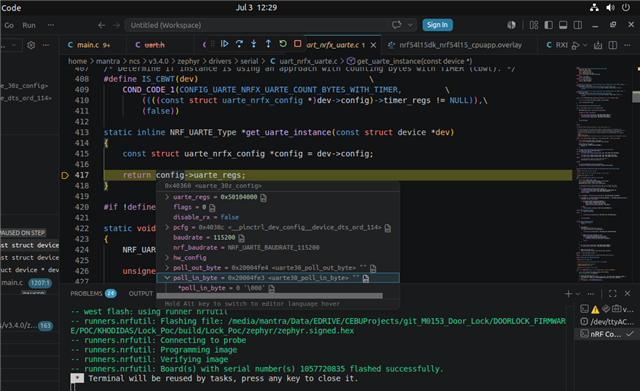

uart30 receive issue
Dear Nordic,
i have started my application with toolchain & sdk both v3.3.0, using custom services & charachteristics, with BLE advertising @500ms interval works fine. but when i disabled VCOM0 from board configurator and then in overlay declaring uart30 pinsP0.0 as TX and P0.1 as RX . Transmit works fine, But recieve not, even in polling mode. when i downgrade sdk and tool chain both to 2.8.0 it started works with all other functionality.
is it issue with sdk and toolchain  3.3.0 &3.31 , or any other method to get it work.
below is prj.conf

  • Hello!
    Thanks for reaching out. Is this a custom board or the nRF54L15 DK? Could you also please share the zephyr.dts file from both the v2.8.0 build and the v3.3.0 build? It would be interesting to compare those.
    Please also edit the overlay to add pull up for RX, like this:
        uart30_default: uart30_default {
            group1 {
                psels = <NRF_PSEL(UART_TX, 0, 0)>;
            group2 {
                psels = <NRF_PSEL(UART_RX, 0, 1)>;
                bias-pull-up;
    Carl Richard
  • Hi, Carl,
    as per your reply already done for pullup , but not worked. Also, i have removed, sdk 3.3.0 and having  only 2.8.0
    check this dts file which is as it is as in sdk. i am just adding peripherals in overlay as you shown for uart30

  • Hi again!
    Ok. What I meant with the zephyr.dts files is the file located under "build/<image_name>/zephyr/zephyr.dts" for the respective 3.3.0 and 2.8.0 builds. I need the file from both builds. Comparing those could make it easier to determine the cause of the issue.
    You can upload the files here on DevZone. No need to copy paste the code.
    Carl Richard
  • Hi, Carl
    this is from 2.8.0

  • today i tried even in sdk 3.4.0 , having same issue
    while deep diving in driver file by debug, it shows no poll_in bytes, even receiving continuosly in loop.
    also for SDK3.4.0  zephyr.dts is
