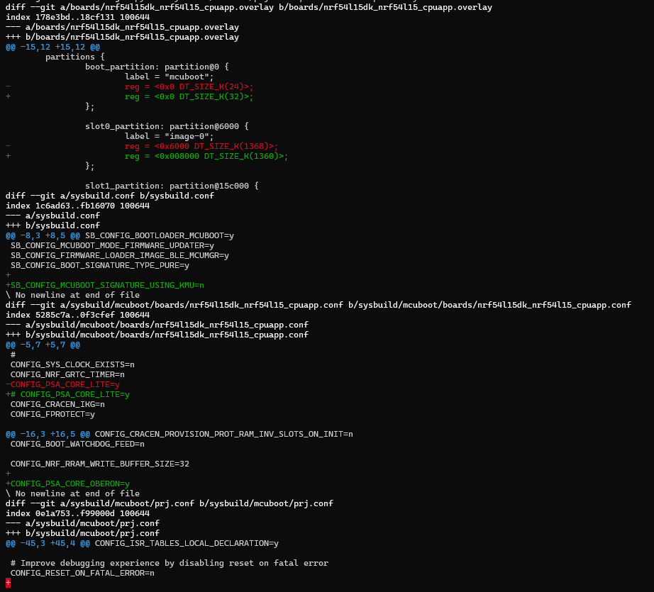

  • Hi AHaug
    I tried to fix the compilation error and it ran successfully. Here are my changes. Could you please help confirm whether this is correct?
    I tried to build with this diff myself.
    Two warnings showed up, both worth mentioning to them:
    • Set your own signing key. With SIGNATURE_USING_KMU=n and no SB_CONFIG_BOOT_SIGNATURE_KEY_FILE, MCUboot embeds the public demo key and you'll see WARNING: Using default MCUboot signing key file in the build log. For production you must set SB_CONFIG_BOOT_SIGNATURE_KEY_FILE to your own .pem.
    • Minor cleanup: rename the DT node from partition@6000 to partition@8000 to match its new reg address and silence the unit address ... don't match warning.
    I recommend that you fix those if you intend to remove the KMU, specially number 1, i.e that you should not use the default public key which it looks like you're currently doing.
    Please also weigh the security trade-off: embedding the key means you lose hardware-backed key storage, hardware-accelerated (CRACEN) verification, and the KMU key-revocation scheme. If those matter, the alternative is to keep the KMU and simply move provisioning into your production line — nrfutil device x-provision-keys doesn't require west, so it can run as one extra step in your existing nrfutil-based flashing script.
    Any associated risks w.r.t security associated with this are up to your discression to evaluate.
