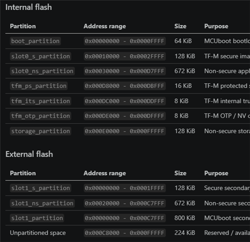

When using custom board definition there are issues with stability.
Custom board definition is minimal. We have defined in device only SOC, mx25r8035f SPI flash and UART (for logging) in dts.
Partitioning is also defined via dts.
One of the issue is same as here where I add the CONFIG_TFM_LOG_LEVEL_SILENCE flag (same issue as [1] ) , the compilaton goes through, but after flash the device fails to boot. Nothing is shown from MCU or application on uart.
When on debugger there is an exception in MCUBoot, that i cannot catch. Looking at the documentation i am slightly lost (for the 3.4.0 release  and DTS there still seem to be some documentation missing for the 91 series.
Is there a minimal working set of configuration flags and dts files that produces stable mcuboot with external flash?
