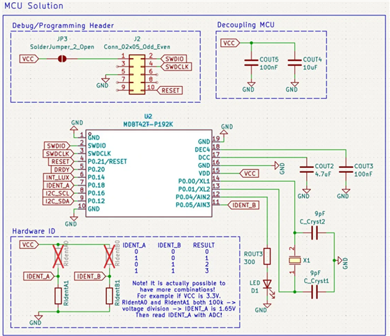

This is the sequence of events:
  • I assembled my custom PCB and connected it to a J-Link programmer.
  • Initially, everything appeared to work. nRF Connect Programmer was able to detect the device as an nRF52805, so I had communication with the chip.
  • I then flashed my Zephyr application from VS Code (nRF Connect SDK). The flash process appeared to start, but after that I completely lost communication with the module.

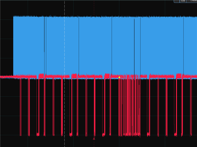

  • SWD communication is physically present. I can see activity on SWDCLK and SWDIO with an oscilloscope when the programmer attempts to connect.

  • I have also tried reset, erase operations available in Programmer, and reconnecting the hardware, but the behavior remains unchanged.

PS C:\Users\danne\blinky> nrfutil device recover --serial-number 1050399544
x Failed to recover 1050399544, Device error: Setting the debug port SELECT register failed while powering up sys and debug regions (Unknown error in the JError: One or more recover tasks failed:
* 1050399544: Device error: Setting the debug port SELECT register failed while powering up sys and debug regions (Unknown error in the J-Link DLL (error code =-1)).
This might indicate that the debug port is unavailable. Double-check device power supply and SWD lines, and ensure that SWD is not disabled (Generic)
Below is the Schematic
