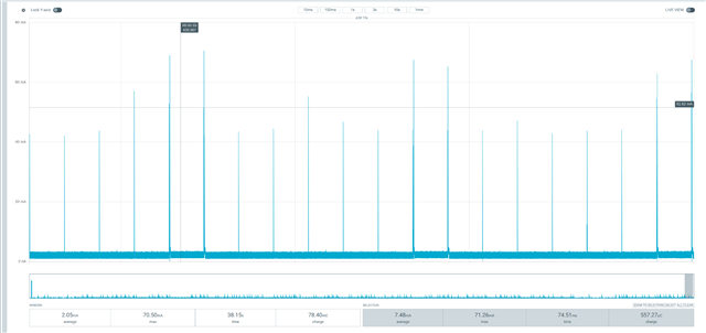

- Current measured with PPK2 (source-meter mode) on the PT while associated and idle (no application traffic)
Observation
With power_save enabled and the PT idle between cluster beacons, the current floor is ~2 mA. Short RX windows on each cluster beacon are visible on top of that floor, so beacon tracking itself works as expected. Increasing the FT cluster beacon period (tested 2000 ms and slower, network beacon 50 ms) does not lower the floor — it only reduces the small beacon-RX duty component, confirming the ~2 mA is the standby baseline of the modem core, not radio duty cycle.
This matches your own blog post "Hands on with DECT NR+ API release v2.0", where the power-save demo shows ~2.2 mA idle during the radio-off periods between beacons.
