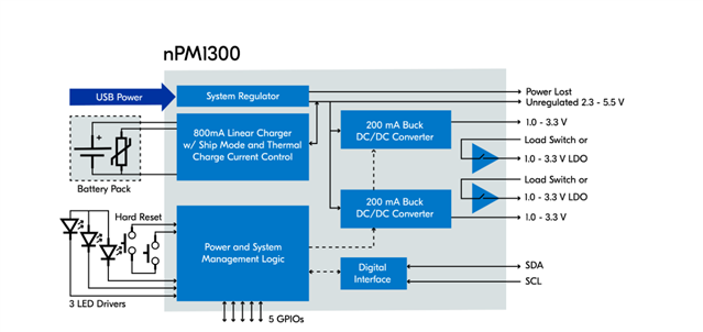

Target item(s): nRF54L15 AON controller and nPM1300 AON/power support
Could you please help with the following?
1. Please confirm recommended nRF54L15 package, land pattern, SDK version and SWD/debug access for a compact wearable AON controller.
2. Please provide RF layout and antenna keep-out guidance for nRF54L15 if BLE is used in the left-temple AON board.
3. Please advise whether nPM1300 is appropriate as an AON support PMIC/gauge block when BQ25895 is the primary charger/power-path IC.
4. Please clarify recommended split of responsibility between nPM1300, BQ25895 and firmware for battery monitoring, low-power rails and shutdown thresholds.
5. Please suggest an evaluation-kit workflow to prove <=25 mW average AON mode and <=50 mW AON ceiling before final PCB layout.
6. Please tell us whether private support or distributor/FAE review is available for schematic and layout before EVT release.
