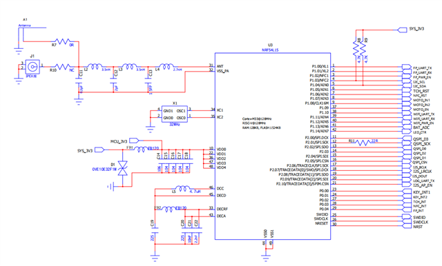

Ticket: Custom Board Fails to Boot After Flashing LED Blink Firmware (Works on nRF54L15-DK)
Problem Description
The custom hardware board cannot boot normally after flashing the firmware. However, the exact same firmware image works perfectly on the official nRF54L15-DK development board. The test project is a simple LED blinking sample with no additional complex logic.
The core difference in hardware configuration is that the custom board does not use an external 32kHz low-speed crystal. All relevant clock configurations have been modified to enable the internal RC oscillator, but the board still fails to start up after firmware flashing.
The detailed hardware schematic is attached in the PDF file for reference.

Questions
1. Are the above DT and Kconfig configurations sufficient to completely switch the 32kHz clock to the internal RC oscillator on nRF54L15, and fully bypass the external LFXO circuit?
2. What other hidden clock configurations, startup prerequisites, or errata may cause the custom board to fail booting when using the internal RC 32kHz clock?
3. Are there any additional firmware modifications required for custom boards without external 32kHz crystals to support normal boot?
4. Are there any other design errors in my hardware schematic that may prevent the system from booting up?
