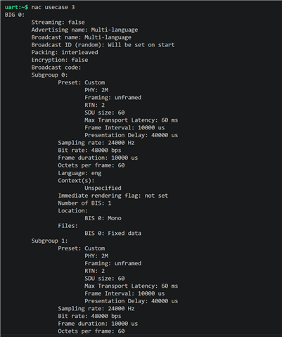

    Look at the Auraconfig sample, specifically use case 3
    Did you test this sample on your end first? It is not the different BIS' that should be switching; rather, the behavior is related to the different subgroups.
    Could you please set up and run the nRF AuraConfig sample? The documentation is available here
    Once the sample is running, please execute usecase 3 and check how the broadcasters are presented on the phone.
    We expect that some newer phone models may display three separate broadcasters. Although these appear as different broadcasters in the user interface, they are actually part of the same BIG (Broadcast Isochronous Group) and represent three different subgroups.
    Please let us know what you observe on your device.
    Øyvind

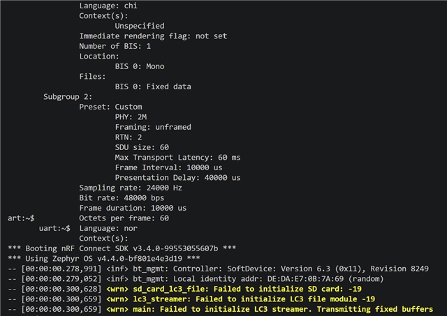

  • I built and flashed the nrf_auraconfig sample. After that, I executed the following commands:
    nac usecase 3
    nac start
    I tried to listen to the Auracast broadcast using a Galaxy S23 and a Sony headset that supports Auracast, but no broadcast was displayed.
    ( In the same environment, the broadcast_source application successfully broadcasted and I was able to receive the Auracast broadcast. )
  • uart:~$ nac start
    -- [00:00:11.979,675] <inf> broadcast_source: Created: 0x2001f2ec Multi-language
    -- [00:00:11.982,788] <inf> bt_mgmt_adv: Local addr: DE:DA:E7:0B:7A:69 (random)
    -- [00:00:11.984,832] <inf> bt_mgmt_adv: Advertising successfully started
    -- [00:00:11.992,858] <inf> broadcast_source: Broadcast stream 0x20006e74 started
    -- [00:00:11.992,889] <inf> le_audio: LC3 codec config for source:
    -- [00:00:11.992,889] <inf> le_audio: Frequency: 24000 Hz
    -- [00:00:11.992,889] <inf> le_audio: Duration: 10000 us
    -- [00:00:11.992,919] <inf> le_audio: Chan alloc: 0x0
    -- [00:00:11.992,919] <inf> le_audio: Oct pr frame: 60 (48000 bps)
    -- [00:00:11.992,919] <inf> le_audio: Frames pr SDU: 1
    -- [00:00:11.993,682] <inf> broadcast_source: Broadcast stream 0x20006fd4 started
    -- [00:00:11.993,713] <inf> le_audio: LC3 codec config for source:
    -- [00:00:11.993,713] <inf> le_audio: Frequency: 24000 Hz
    -- [00:00:11.993,713] <inf> le_audio: Duration: 10000 us
    -- [00:00:11.993,713] <inf> le_audio: Chan alloc: 0x0
    -- [00:00:11.993,713] <inf> le_audio: Oct pr frame: 60 (48000 bps)
    -- [00:00:11.993,743] <inf> le_audio: Frames pr SDU: 1
    -- [00:00:11.994,812] <wrn> main: TX sync timestamp is invalid
    -- [00:00:11.995,361] <inf> broadcast_source: Broadcast stream 0x20007134 started
    -- [00:00:11.995,391] <inf> le_audio: LC3 codec config for source:
    -- [00:00:11.995,391] <inf> le_audio: Frequency: 24000 Hz
    -- [00:00:11.995,391] <inf> le_audio: Duration: 10000 us
    -- [00:00:11.995,391] <inf> le_audio: Chan alloc: 0x0
    -- [00:00:11.995,422] <inf> le_audio: Oct pr frame: 60 (48000 bps)
    -- [00:00:11.995,422] <inf> le_audio: Frames pr SDU: 1
    -- [00:00:11.995,422] <inf> broadcast_source: Source 0x2001f2ec started
    -- [00:00:11.995,422] <inf> broadcast_source: Index: 0
    -- [00:00:11.995,422] <inf> broadcast_source: ID: 15562472
    -- [00:00:11.995,452] <inf> broadcast_source: Num subgroups: 3
    -- [00:00:11.995,452] <inf> broadcast_source: Not encrypted
    -- [00:00:11.996,307] <wrn> main: TX sync timestamp is invalid
    --- 2 messages dropped ---
    -- [00:00:11.997,344] <wrn> main: TX sync timestamp is invalid
    --- 8 messages dropped ---
    -- [00:00:12.004,913] <wrn> bt_le_audio_tx: Audio tx called with interval of 0 us, (min 7500 us, max 12500 us) expected around 10000 us. Resync with controller
    --- 12 messages dropped ---
    -- [00:00:12.006,042] <wrn> main: TX sync timestamp is invalid
    --- 7 messages dropped ---
    -- [00:00:12.006,408] <wrn> bt_le_audio_tx: Audio tx called with interval of 0 us, (min 7500 us, max 12500 us) expected around 10000 us. Resync with controller
    -- [00:00:12.007,415] <wrn> main: TX sync timestamp is invalid
    --- 6 messages dropped ---
    -- [00:00:12.007,598] <wrn> bt_le_audio_tx: Audio tx called with interval of 0 us, (min 7500 us, max 12500 us) expected around 10000 us. Resync with controller
    -- [00:00:12.008,575] <wrn> main: TX sync timestamp is invalid
    -- [00:00:12.016,143] <wrn> bt_le_audio_tx: Audio tx called with interval of 0 us, (min 7500 us, max 12500 us) expected around 10000 us. Resync with controller
    -- [00:00:12.017,120] <wrn> main: TX sync timestamp is invalid
    -- [00:00:12.017,517] <wrn> bt_le_audio_tx: Audio tx called with interval of 0 us, (min 7500 us, max 12500 us) expected around 10000 us. Resync with controller
    -- [00:00:12.018,493] <wrn> main: TX sync timestamp is invalid
    -- [00:00:12.018,707] <wrn> bt_le_audio_tx: Audio tx called with interval of 0 us, (min 7500 us, max 12500 us) expected around 10000 us. Resync with controller
    --- 10 messages dropped ---
    -- [00:00:12.019,744] <wrn> main: TX sync timestamp is invalid
    -- [00:00:12.027,221] <wrn> bt_le_audio_tx: Audio tx called with interval of 0 us, (min 7500 us, max 12500 us) expected around 10000 us. Resync with controller
    --- 11 messages dropped ---
    -- [00:00:12.028,381] <wrn> main: TX sync timestamp is invalid
    -- [00:00:12.029,968] <wrn> bt_le_audio_tx: Audio tx called with interval of 0 us, (min 7500 us, max 12500 us) expected around 10000 us. Resync with controller
    --- 9 messages dropped ---
    -- [00:00:12.050,628] <wrn> main: TX sync timestamp is invalid
    -- [00:00:12.073,455] <wrn> bt_le_audio_tx: Audio tx called with interval of 0 us, (min 7500 us, max 12500 us) expected around 10000 us. Resync with controller
    -- [00:00:12.086,303] <wrn> bt_le_audio_tx: Audio tx called with interval of 0 us, (min 7500 us, max 12500 us) expected around 10000 us. Resync with controller
    -- [00:00:12.109,466] <wrn> main: TX sync timestamp is invalid
    -- [00:00:12.127,624] <wrn> bt_le_audio_tx: Audio tx called with interval of 0 us, (min 7500 us, max 12500 us) expected around 10000 us. Resync with controller
    -- [00:00:12.150,939] <wrn> main: TX sync timestamp is invalid
    -- [00:00:12.162,811] <wrn> bt_le_audio_tx: Audio tx called with interval of 0 us, (min 7500 us, max 12500 us) expected around 10000 us. Resync with controller
    -- [00:00:12.186,492] <wrn> main: TX sync timestamp is invalid
    --- 5 messages dropped ---
    -- [00:00:12.197,998] <wrn> bt_le_audio_tx: Audio tx called with interval of 0 us, (min 7500 us, max 12500 us) expected around 10000 us. Resync with controller

  • I confirmed that  use case 0, 1 , 2 are working normally.
    However, in use case 3, the following error still occurs:
    bt_le_audio_tx: Audio tx called with interval of 6900 us
    bt_le_audio_tx: Audio tx called with interval of 12607 us
    I am using nRF Connect SDK v3.4.0 (LTS).
    Additionally, I added the USB-related files from the nRF Audio application to the nRF Auraconfig sample and modified the code to broadcast the frame_out encoded through encoder_thread() in the nRF Audio application.
    However, in the following environment:
    Windows PC <- USB A-to-C -> nRF5340 Audio DK
    Windows does not recognize the nRF5340 Audio DK as an audio output device, and broadcasting does not work.

    1. Passing frame_out from encoder_thread() to subgroup_send() in nRF Auraconfig
    nRF Auraconfig is passing files stored on the SD card or fixed buffers.
    I want to receive audio input from USB in nRF Auraconfig, encode it through encoder_thread(), and pass the generated frame_out to subgroup_send() so that it can be broadcast and heard.
    I would like to know the required environment settings and configuration for this.
    2. Adding nrf_auraconfig.c to the nRF Audio application
    If I add nrf_auraconfig.c to the nRF Audio application, I want the command-based nRF Auraconfig to continue working with the existing functionality using use case 1:
    1 BIG
    1 Subgroup
    2 BIS (Stereo)
    without changing the existing application behavior.
    Later, during the encoding process, I want to split the left and right channels, encode them separately, and use nRF Auraconfig as:
    1 BIG
    2 Subgroups
    2 BIS (Mono)
    The CMakeLists.txt file of nRF Auraconfig is as follows.

  • *** Booting nRF Connect SDK v3.4.0-99553055607b ***
    *** Using Zephyr OS v4.4.0-bf801e4e3d19 ***
    -- [00:00:00.258,697] <wrn> location: Invalid location in UICR, using default location
    -- [00:00:00.284,820] <inf> bt_mgmt: Controller: SoftDevice: Version 6.3 (0x11), Revision 8249
    -- [00:00:00.284,881] <inf> bt_mgmt: Local identity addr: DE:DA:E7:0B:7A:69 (random)
    -- [00:00:00.284,942] <inf> audio_usb: USB initialized as unidirectional (headphones only).
    -- [00:00:00.285,156] <inf> audio_usb: Ready for USB host to send/receive: No Sync (multi-clock)
    -- [00:00:00.306,304] <wrn> sd_card_lc3_file: Failed to initialize SD card: -19
    -- [00:00:00.306,304] <wrn> lc3_streamer: Failed to initialize LC3 file module -19
    -- [00:00:00.306,335] <wrn> main: Failed to initialize LC3 streamer. Transmitting fixed buffers

    uart:~$ nac start 0
    -- [00:00:16.754,150] <inf> broadcast_source: Created: 0x20027bc4 TV-audio
    -- [00:00:16.756,958] <inf> bt_mgmt_adv: Local addr: DE:DA:E7:0B:7A:69 (random)
    -- [00:00:16.759,735] <inf> bt_mgmt_adv: Advertising successfully started
    -- [00:00:16.768,127] <inf> broadcast_source: Broadcast stream 0x200090cc started
    -- [00:00:16.768,157] <inf> le_audio: LC3 codec config for source:
    -- [00:00:16.768,157] <inf> le_audio: Frequency: 24000 Hz
    -- [00:00:16.768,157] <inf> le_audio: Duration: 10000 us
    -- [00:00:16.768,157] <inf> le_audio: Chan alloc: 0x1
    -- [00:00:16.768,157] <inf> le_audio: Oct pr frame: 60 (48000 bps)
    -- [00:00:16.768,157] <inf> le_audio: Frames pr SDU: 1
    -- [00:00:16.768,310] <inf> audio_system: Gateway configured for 2 encoder channels
    -- [00:00:16.768,798] <inf> broadcast_source: Broadcast stream 0x200090f8 started
    -- [00:00:16.768,798] <inf> le_audio: LC3 codec config for source:
    -- [00:00:16.768,829] <inf> le_audio: Frequency: 24000 Hz
    -- [00:00:16.768,829] <inf> le_audio: Duration: 10000 us
    -- [00:00:16.768,829] <inf> le_audio: Chan alloc: 0x2
    -- [00:00:16.768,829] <inf> le_audio: Oct pr frame: 60 (48000 bps)
    -- [00:00:16.768,829] <inf> le_audio: Frames pr SDU: 1
    -- [00:00:16.768,829] <inf> broadcast_source: Source 0x20027bc4 started
    -- [00:00:16.768,829] <inf> broadcast_source: Index: 0
    -- [00:00:16.768,859] <inf> broadcast_source: ID: 2950679
    -- [00:00:16.768,859] <inf> broadcast_source: Num subgroups: 1
    -- [00:00:16.768,859] <inf> broadcast_source: Encrypted with key: Auratest
    -- [00:00:19.813,171] <err> sw_codec_select: Encode failed

    -- [00:00:19.813,201] <err> os: s[ 8]: 0xffffec72 s[ 9]: 0x20002994 s[10]: 0x20006d00 s[11]: 0x00000001
    -- [00:00:19.813,201] <err> os: s[12]: 0x00000001 s[13]: 0x2002d9c8 s[14]: 0x200483fc s[15]: 0x0001142f
    -- [00:00:19.813,201] <err> os: fpscr: 0x00000001
    -- [00:00:19.813,232] <err> os: Faulting instruction address (r15/pc): 0x0000bbd6
    -- [00:00:19.813,232] <err> os: >>> ZEPHYR FATAL ERROR 3: Kernel oops on CPU 0
    -- [00:00:19.813,262] <err> os: Current thread: 0x200061d8 (Encoder)
    -- [00:00:19.959,472] <err> os: Halting system
    I successfully detected the USB device, but I'm now encountering a buffer allocation issue and an encoding failure.

    I separated the broadcast into two subgroups and implemented the code so that each encoded audio stream (KOR and ENG) can be transmitted through different subgroups. The KOR audio is assigned to SUB0, and the ENG audio is assigned to SUB1.
    However, only the KOR audio is being broadcast. The audio from SUB0 also affects SUB1, so the KOR audio can be heard from SUB1 as well. I verified that KOR and ENG are different audio streams by broadcasting them separately through only SUB0.
    My question is: I called subgroup_send() with different audio frames according to each subgroup, but why is the audio assigned to SUB0 also being transmitted through SUB1?
    I modified subgroup_send() so that it receives the encoded audio frame as an argument and sends it using broadcast_source_send(audio_frame, stream_idx.lvl1, stream_idx.lvl2). I expected the behavior to be:
    • SUB0 → KOR audio → BIG0
    • SUB1 → ENG audio → BIG1
    However, the actual behavior is:
    • SUB1 → KOR audio → BIG1
    It seems that the frame buffer or stream mapping is still shared between the subgroups.
    I would like to know if there is any additional configuration or buffer separation required when using multiple subgroups. Also, does broadcast_source_send() use the subgroup index (lvl1, lvl2) only for routing, or is there another internal mechanism that determines which LC3 frame is transmitted for each subgroup?
