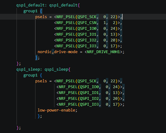

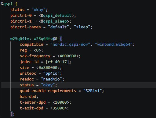

I have a customized nRF52840 board with an external NOR Flash (W25Q64FV), and I have some confusion when conducting read and write data testing.
This is my device tree configuration:
This is my test code:

然后向设备树添加:
writeoc = “pp4io”;
readoc = “read4io”;

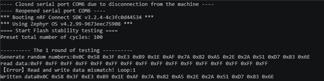

启用Quad SPI时,所有数据输出均为数据0xFF,如图所示
注释后,所有读写数据都正常。我认为是:四联启用要求=“S2B1v1”;不起作用(QE)或其他原因。
另外,我的设备树配置是否正常,代码是否存在问题,请给我一些建议
