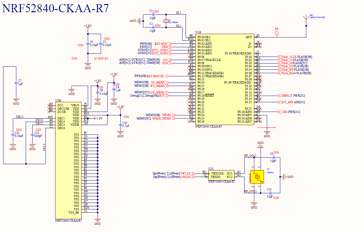

  • Custom flex PCB (smart-ring form factor), SoC: nRF52840-CKAA-R7 (WLCSP package)
  • Supply: nPM1100 buck (VOUTB) at 1.8 V, normal voltage mode

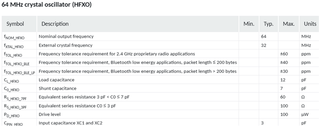

  • HFXO: 32 MHz crystal (X2) with 12 pF load capacitors on XC1/XC2 — exact crystal model and full schematic attached
  • Soldering and connectivity have been verified by X-ray inspection — the crystal and MCU balls show no opens, bridges, or head-in-pillow defects. This is not an assembly issue.

HFXO manufacturer part no: X201632MKB4SI
Datasheet: https://www.lcsc.com/datasheet/C718072.pdf?spm=wm.sxq.inf.ggs&lcsc_vid=TwcIAgUAFFkIUVEFR1gKUAEFR1NXUgYDFVJXV1FUFFQxVlNeQ1FcX11RR1RXUTsOAxUeFF5JWBYZEEoBGA4JCwFIFA4DSA%3D%3D
Schematic
