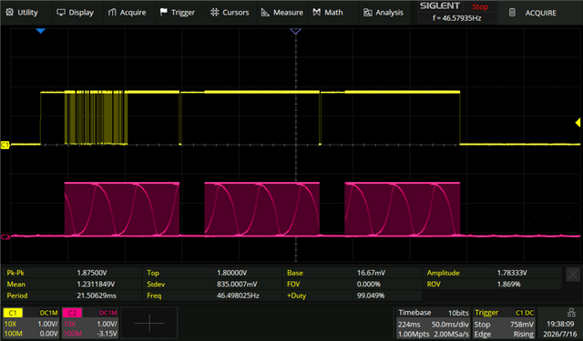

  • AT+CFUN=41 --> OK; SIM_VCC pulses ~360 ms with retries

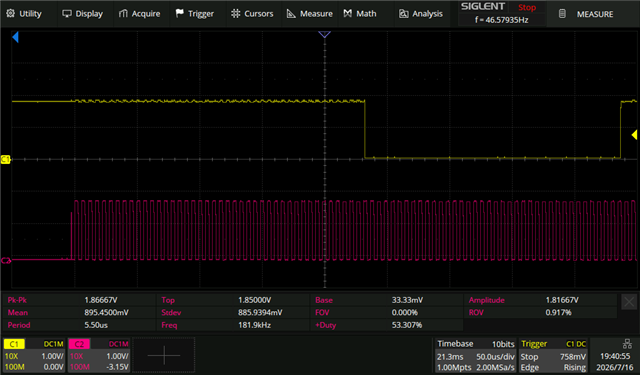

  • Oscilloscope at the socket during activation: CLK clean 1.818 MHz (varies 200 kHz-1.8 MHz across retries), RST 2-3 pulses ~100 ms, I/O shows clean digital data - the card IS responding

Modem drives VCC/CLK/RST correctly and the card responds on I/O (visible on scope at SIM socket and P28), but the modem never receives a valid ATR.
sim 1NCE, trace-2026-07-16T18-04-57.255Z.mtrace
Does this look like a hardware fault to you, or did I miss something? If it is hardware, I'd like to proceed with an RMA.
