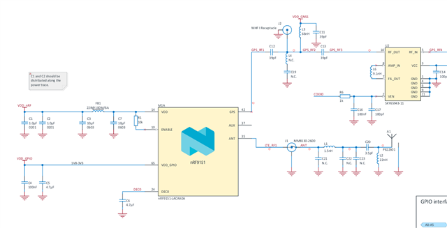

1. COEX0 load capacitance
The current COEX hardware-design guidance states that the total load capacitance on the COEX pins, including routing parasitics, must not exceed 50 pF.
However, the nRF9151 DK schematic appears to connect COEX0 to discrete capacitance whose nominal total is greater than 50 pF.
Could Nordic please clarify:
  1. Does the limit depend on how COEX0 is used—for example, coexistence signaling versus external GNSS LNA control?
  2. Is the DK implementation a validated exception that should not be copied into a different layout?

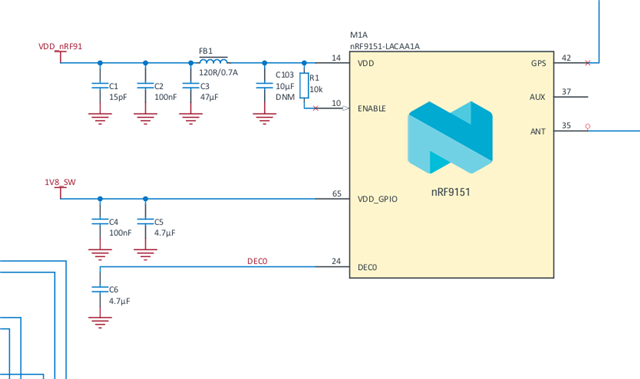

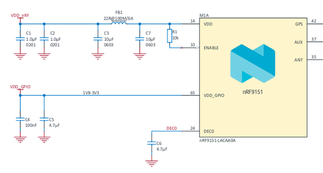

The current recommended nRF9151 application schematic uses:
  • 1 µF + 1 µF on the source side of the VDD ferrite bead
  • 47 µF + 10 µF on the nRF9151 side
  • A 22 Ω at 100 MHz, 6 A, low-DCR ferrite bead
The VDD capacitor values and/or their placement around the ferrite bead appear different in the nRF9151 DK schematic:
Similarly, the Thingy91x shows something different as well:

    The Hardware Design Guidelines and the Reference Design in the Product Specification is always the standard that should be considered. The DK and the Thingy is for evaluation purposes, not for reference.
    Answering your questions:
    1. The capacitance directly on the pin should not exceed 50pF. Here, the capacitors are not connected directly to the pin, but through a 1K resistor, so it is fine. This restriction for COEX0 and COEX2 is always valid.
    2. This is the reference for the power supply filtering:
      It is OK to use 10uF instead of the 47uF, but 47uF is the officially recommended value.
    3. When powered by nPM1300, VDD is usually connected to VSYS, and VDD_GPIO is connected to the digital supply (usually a buck output).
