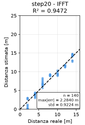

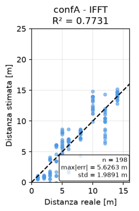

ISSUE 1 - CS_CHANNEL_MAP_REPETITION counter-intuitive behavior
Comparing two configurations, single channel map repetition (72 steps, repetition=1) gives better accuracy results than repetition=2 with the same number of steps, contrary to the expectation that more repetitions (= more IQ samples) should improve the estimate. This behavior was confirmed also in an obstacle-free LOS environment, across repeated tests.
Config A (repetition=1) - result:
Config B (repetition=2) - result:
Questions:
  1. Is this behavior plausible, or does it indicate a configuration error on our side?
  2. Which other parameters significantly affect accuracy and should be varied to verify a potential benefit from repetition>1?
  3. Any suggestions on how to set the CS parameters to obtain real benefits from multiple channel map repetitions?
