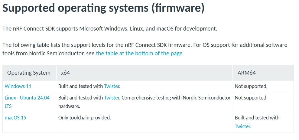

  • Thanks, MJJ, for the quick reply.  No joy after flashing your hex file (by drag and drop).  Produced the usual "Disk not ejected properly" msg.  But no serial output on the debug USB-C ports.
    Hmm... Apple M5 USB ports?
    Will try this on my old Mac.
    Mike
  • No joy.  No serial output on old Mac either.
