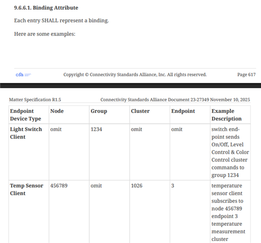

  • Hi Maria,
    I have looked further into the Matter 1.5 standard.
    My understanding is that a binding can exist which specifies the end node (or group) without giving a cluster number. The binding node app will then be able to control any available cluster on the end node or group.
    The image shows an example given in the Matter spec where a group is specified but the nodes and clusters are omitted.
    The HA Matter server creates a single binding table where the controlling node and end node are included but the cluster number is omitted. I thank this is correct but is why the "print binding table" function fails becaue it expects a cluster number.
    Best regards
    Tony
