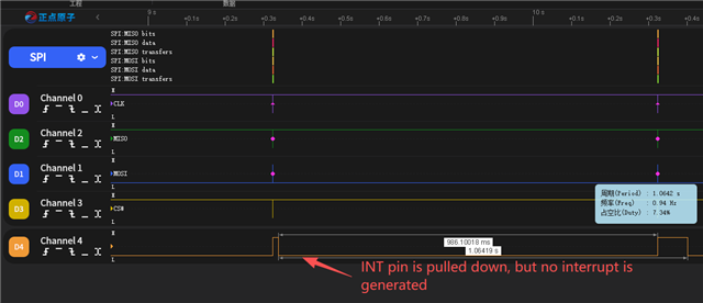

The INT pin is pulled down, but sometimes it takes 1 second to interrupt
Hi:
I use ncs 3.3.0 and nrf54lm20dk.
USB mode running phenomenon: Mouse stuttering.
But use ncs 3.1.0 mouse is very smooth.
Since the ncs3.1.0 version does not support nrf54lm20 BLE, I switched to ncs3.3.0.

    //printf("Interrupt on pin %d\n", pin);
    /* 使用 k_uptime_get() 手动添加时间戳 */
    //printf("[%lld ms] Interrupt pin\n", k_uptime_get());
    pmw3360_irq_disable();
    k_event_post(&pmw3360_event, PMW3360_EVENT_DATA_READY);
static void pmw3360_irq_init(void)
    int err;
    /* 添加 static const,确保生命周期贯穿整个运行时 */
    static const nrf_gpio_pin_pull_t pull_config = NRF_GPIO_PIN_PULLUP;
    static const nrfx_gpiote_trigger_config_t trigger_config = {
        .trigger      = NRFX_GPIOTE_TRIGGER_LOW,
        .p_in_channel = NULL,
    static const nrfx_gpiote_handler_config_t handler_config = {
        .handler   = gpiote_evt_handler,
        .p_context = NULL,
    static const nrfx_gpiote_input_pin_config_t input_pin_config = {
        .p_pull_config    = &pull_config,
        .p_trigger_config = &trigger_config,
        .p_handler_config = &handler_config,
    err = nrfx_gpiote_input_configure(gpiote_inst,
                                      IRQ_PIN,
                                      &input_pin_config);
    if (err) {
        printf("nrfx_gpiote_input_configure failed: 0x%x\n", err);
        return;
void pmw3360_irq_enable(void)
    /* 中断使能代码... */
    //printf("[%lld ms] Interrupt enable\n", k_uptime_get());
    nrfx_gpiote_trigger_enable(gpiote_inst, IRQ_PIN, true);
    // 重新使能后检查引脚是否仍为低电平
    if (nrf_gpio_pin_read(IRQ_PIN) == 0) {
        // 引脚仍为低,手动补发事件
void pmw3360_irq_disable(void)
    nrfx_gpiote_trigger_disable(gpiote_inst, IRQ_PIN);

        /* 只有上次不是突发读取时,才需要写入触发命令 */
        err = pmw3360_reg_write(PMW3360_REG_MOTION_BURST, 0x00);
        if (err) {
            printf("Failed to trigger motion burst\n");
            return err;
        /* reg_write 内部已经包含了:
         * - CS控制 (拉低→写→拉高)
         * - T_SCLK_NCS_WR (35us)
         * - T_SWX (180us)
     * 步骤2: 读取突发数据
    /* 2.1 CS拉低,开始SPI传输 */
    spi_cs_ctrl(true);
    /* 2.2 发送突发读取地址 (0x50) */
    tx = PMW3360_REG_MOTION_BURST;
    spi_write(&tx, 1);
    /* 2.3 关键延迟:等待传感器准备数据 (35us) */
    /* 注意:这个延迟必须在地址发送之后、数据读取之前 */
    k_busy_wait(T_SRAD_MOTBR);
    /* 2.4 连续读取6个字节 */
    /* 注意:读取时发送0xFF来产生SPI时钟 */
    // for (int i = 0; i < PMW3360_MOTION_BURST_SIZE; i++) {
    //     uint8_t dummy = 0xFF;
    //     spi_read(&rx[i], 1);
    //     /* 如果SPI是半双工,可以分开操作:
    //      * spi_write(&dummy, 1);
    //      * spi_read(&rx[i], 1);
    spi_read(rx, PMW3360_MOTION_BURST_SIZE);
    /* 2.5 结束SPI传输 */
    spi_cs_ctrl(false);
    k_busy_wait(T_BEXIT);
     * 步骤3: 标记已完成突发读取
    last_read_burst = true;
     * 步骤4: 解析数据
    if (dx && dy) {
        /* 注意:PMW3360的数据是小端格式 */
        *dx = (int16_t)((rx[PMW3360_DX_POS + 1] << 8) | rx[PMW3360_DX_POS]);
        *dy = (int16_t)((rx[PMW3360_DY_POS + 1] << 8) | rx[PMW3360_DY_POS]);
        /* 可选:数据有效性检查 */
        /* PMW3360运动数据范围通常是 -32768 ~ 32767 */
        /* 如果dx和dy都为0,可能表示静止或读取失败 */
    return 0;
static int pmw3360_upload_firmware(void)
    int err;
    uint8_t val;
    printf("Uploading PMW3360 firmware...\n");
    /* 读取运动寄存器清除状态 */
    for (uint8_t reg = 0x02; reg <= 0x06; reg++) {
        pmw3360_reg_read(reg, &val);
    /* 禁用Rest模式 */
    pmw3360_reg_write(PMW3360_REG_CONFIG2, 0x00);
    /* 初始化SROM */
    pmw3360_reg_write(PMW3360_REG_SROM_ENABLE, 0x1D);
    /* 延迟17: 等待SROM初始化完成 (50 ms) */
    k_sleep(K_MSEC(10));  /* 关键延迟:固件加载前的准备时间 */
    /* 开始SROM下载 */
    pmw3360_reg_write(PMW3360_REG_SROM_ENABLE, 0x18);
    /* 上传固件 */
    //printf("PMW3360_REG_SROM_LOAD_BURST fw=%d\n", pmw3360_firmware_length);
    pmw3360_burst_write(PMW3360_REG_SROM_LOAD_BURST,
                               pmw3360_firmware_data,
    /* 延迟18: 等待固件加载完成 (10 ms) */
    k_sleep(K_MSEC(10));  /* 关键延迟:固件验证前的等待时间 */
    /* 验证固件ID */
    err = pmw3360_reg_read(PMW3360_REG_SROM_ID, &val);
    if (err) return err;
    printf("Firmware ID: 0x%02X (expected: 0x%02X)\n", val, PMW3360_FIRMWARE_ID);
    if (val != PMW3360_FIRMWARE_ID) {
        printf("Invalid firmware ID\n");
        return -EIO;
    /* 验证产品ID */
    err = pmw3360_reg_read(PMW3360_REG_PRODUCT_ID, &val);
    if (val != PMW3360_PRODUCT_ID) {
        printf("Invalid product ID: 0x%02X\n", val);
        return -EIO;
    /* 启用Rest模式 */
    err = pmw3360_reg_write(PMW3360_REG_CONFIG2, 0x20);
    printf("Firmware upload successful\n");
    return 0;
/* ==================== PMW3360 配置 ==================== */
static int pmw3360_configure(uint32_t cpi)
    uint8_t value;
    /* 设置CPI */
    if (cpi < 100 || cpi > 12000) {
        printf("Invalid CPI value: %u\n", cpi);
        return -EINVAL;
    value = (cpi / 100) - 1;
    pmw3360_reg_write(PMW3360_REG_CONFIG1, value);
    /* 2. ? 禁用Rest模式,强制Run模式(最高帧率) */
    printf("PMW3360 configured: CPI=%u, Rest mode disabled (always Run)\n", cpi);
    return 0;
/* 初始化PMW3360 */
int pmw3360_init(uint32_t cpi)
    int err;
    gpiote_inst = get_gpiote_inst();
    printf("pmw3xx gpiote_inst = %p\n", (void*)gpiote_inst);
    pmw3360_irq_init();   /* 初始化运动中断 */
    printf("pmw3360_irq_init\n");
    /* 复位传感器 */
    err = pmw3360_reg_write(PMW3360_REG_POWER_UP_RESET, 0x5A);
    printf("pmw3360_reg_write err=%d\n", err);
    if (err) {
        printf("Reset failed. err=%d\n", err);
        return err;
    /* 延迟19: 复位后等待传感器稳定 (1 ms) */
    k_sleep(K_MSEC(50));  /* 关键延迟:上电复位后的稳定时间 */
    /* 上传固件 */
    err = pmw3360_upload_firmware();
    if (err) {
        printf("Firmware upload failed. err=%d\n", err);
        return err;
    /* 配置传感器 */
    err = pmw3360_configure(cpi);
    if (err) {
        printf("Configuration failed. err=%d\n", err);
    initialized = true;
    printf("PMW3360 initialized (CPI=%u)\n", cpi);
    return 0;
/* 线程入口函数 */
void pmw3360_thread(void *p1, void *p2, void *p3)
    int err;
    enum state new_state = STATE_IDLE;
    int16_t dx=0,dy=0;
    k_event_init(&pmw3360_event);
    spi_init();
    err = pmw3360_init(1600);
    //pmw3360_irq_enable();
    while (1) {
        /* 替代 k_event_wait_safe */
        uint32_t events = k_event_wait(&pmw3360_event,
                                       PMW3360_EVENT_DATA_READY,
                                       false,        /* reset=false */
                                       K_FOREVER);//K_MSEC(200)
        //if (events & PMW3360_EVENT_DATA_READY)
            bool is_timed_tx = (atomic_get(&ptx_delay) > 0);
            if(!is_timed_tx) {
                pmw3360_motion_burst_read(&dx, &dy);
            } else {
                dx = 1;
                dy = 1;
                start_motion_idle_timer();
            /* 手动原子清除,紧接在判断之后 */
            k_event_clear(&pmw3360_event, PMW3360_EVENT_DATA_READY);
            //printf("PMW3360: dx=%d,dy=%d\n",dx,dy);
#if CONFIG_USBD_HID_SUPPORT
            //printf("rf status=%d.\n", rf_motion_status());
            // 如果是定时发送,且(USB有动作 或 RF有动作),则跳过
            if (is_timed_tx && (usb_motion_status())) { //|| rf_motion_status()
#else
            if (is_timed_tx && rf_motion_status()) {
                continue;
            /* 只有有实际运动时才写入,减少无效数据 */
            if (dx != 0 || dy != 0) {
                motion_data_t data = { .dx = dx, .dy = dy };
                //printf("[%lld ms] mutex_lock\n", k_uptime_get());
                k_mutex_lock(&pmw3360_mutex, K_FOREVER);
                uint32_t written = ring_buf_put(&motion_ring_buf,
                                                (uint8_t *)&data,
                                                sizeof(data));
                k_mutex_unlock(&pmw3360_mutex);
                //printf("[%lld ms] mutex_unlock\n", k_uptime_get());
                if (written == sizeof(data)) {
                    //new_state = STATE_MOTION;
                    struct main_msg msg;
                    msg.type = MAIN_MSG_MOTION;
                    msg.cnt = 1;
                    int err = k_msgq_put(&main_msgq, &msg, K_NO_WAIT);
                    if (err) {
                        printf("Cannot put button event to message queue: %d\n", err);
                } else {
                    /* 缓冲区满,可在此记录溢出或丢弃 */
                    printf("ring buf full, data dropped\n");
/* 编译时定义并启动线程 */
K_THREAD_DEFINE(pmw3360_tid,
                PMW3360_THREAD_STACK_SIZE,
                pmw3360_thread,
                NULL, NULL, NULL,
                PMW3360_THREAD_PRIORITY,
                0,
                0);  /* delay=0,立即启动 */
