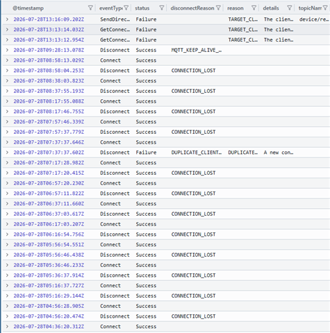

We have a product in the field using the NRF9160 and AWS IOT MQTT from NRF Connect SDK 3.1.1.  It is always connected when awake (power cycle controlled by an external micro) and sends heartbeat messages once a minute as well as other application traffic.  We find that after several days of operation without going to sleep it will go into a mode where application content and heartbeat messages stop being received at all.  The only thing we see at this point is MQTT Connect and Disconnects every KEEPALIVE timeout which is 20 minutes.  This persists through multiple ip address changes and can last for 18 hours+.  Eventually we see an AWS broker timeout (KEEPALIVE * 1.5) and we never see another MQTT connect. Interestingly if we go into our carrier's portal we can see that even after days in this state there is still an active PDP context.  A power cycle resolves the issue.

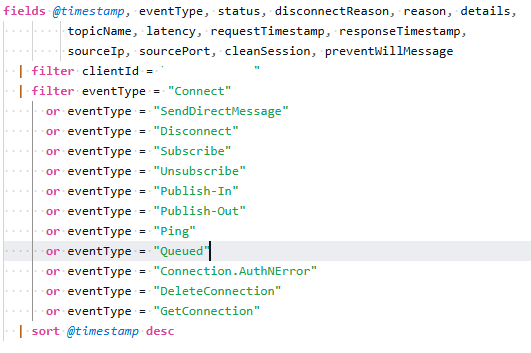

When looking at AWS CloudWatch logs for a unit in question querying:
results in:
This reads to me as:
  • During the initial issue, mqtt_helper is getting stuck in the connecting state by never receiving it's CONN_ACK but, at a low level, not just missing receiving the event.
  • Given that this is TCP and the session remains active after the CONN_ACK is sent, the data must be being delivered to the modem core itself but that data must not propagate to the zephyr IP stack or perhaps up the chain to the MQTT stack.
  • Also it happens 20+ times in a row so it's not likely a one off, just missed the response issue (despite that not really being possible due to TCP).
  • If we just missed receiving the conn_ack and no application traffic would be passed because we are still just in the connecting phase I'd expect a ping to go out but the ping must be failing.  Aborting in the mqtt_helper_poll_loop after the ret = mqtt_live(&mqtt_client);
    • This should explain the 20 minute target initiated disconnects (see attached picture)
  • The NRF9160 must still be on and running it's L4 reconnects or we wouldn't have PDP context with the sim days afterwards but some how the MQTT library or it's callers are getting totally locked up.

  • Syed,
    Your reiteration of my statement matches my problem correctly!  After power cycling the mqtt connect/disconnect looping stops and normal operation begins.  Modem firmware is1.3.7 as you mentioned.
    It takes days of operation to get into the state and is hard to reproduce even if we leave it.  Can we take a multiday modem trace?
    Nick
    Okay, thanks for confirmation. Yes I understand it could be hard to reproduce but to investigate it further we request you to share the traces showing the issue and also it would be great we could also get some minimal project files too.
