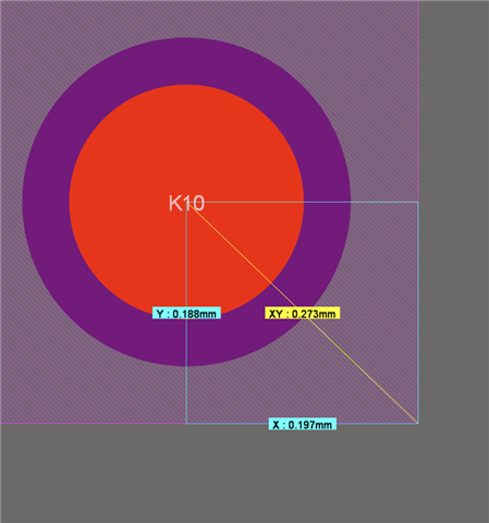

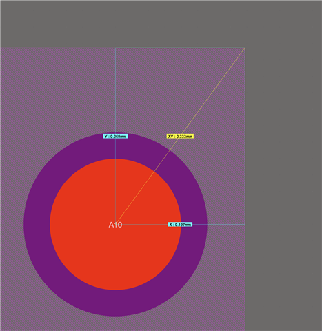

I have just downloaded the NRF52840 Reference Altium Library.
I have noticed that the step file for the component is not symmetrical about the origin.
If I measure from pin A10 to the top, I get 0.269mm.
From pin K10 to the bottom, I get 0.188mm.

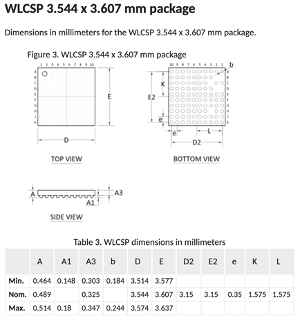

Looking at the package drawing from the part documentation, I see no indication of this offset. The package appears to be symmetrical about the origin.
Is the reference footprint incorrect? Or am I misunderstanding the drawing somehow?
David

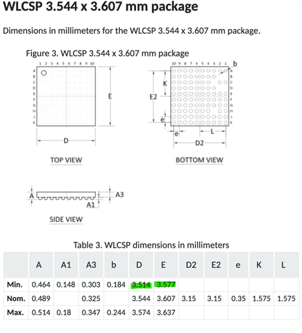

    Your impression is correct, I could also check it on Altium reference design files . Regarding the package drawing, the distance from edge to ball is not presented . So it does not necessarily reject the observation you had. The total package dimension also gives similar impression, E is slightly bigger than D.
