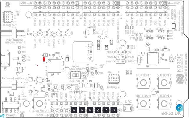

  • Hi Emlyn,
    I should have asked you in a previous reply, but what are you measuring on the VBUS input to the ODB nRF5340?
    See the red arrow for the location of the R9, C35 and C36 cap on the VBUS input. When the cable and everything is plugged in, what voltage are you measuring there on these three components?
    Best regards
    Asbjørn
  • 5.18V on the bottom pads of the two left most components (R/C) and 0V on the bottom of the right component of the three (the other cap).
    Resistor is measuring 2ohms,
    Top pads of the two caps measure zero
    So:
    5.18     0       0
    5.18   5.18    0
    A full schematic would be helpful to diagnose.
    The P1 VDDs have 3v reading
