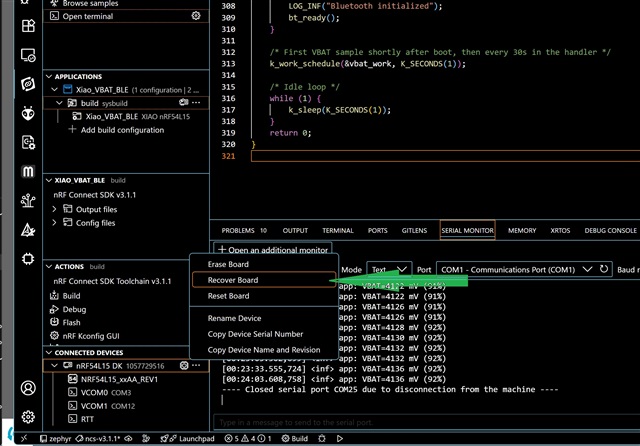

  • Hi there,
    So in the devices view in NRF_SDK in VB, there is a " RECOVER BOARD" Did you try that First ?
    It can happen that some code or issue can corrupt the board , Clicking recover will return it to normal.
    DO you know where that option is ?
