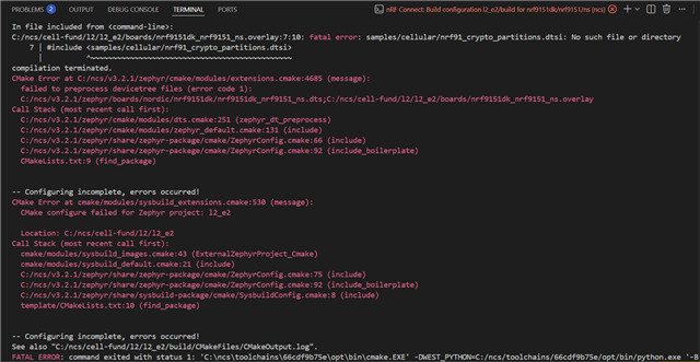

Missing files on build for l2_e2 exercise for IoT fundamentals

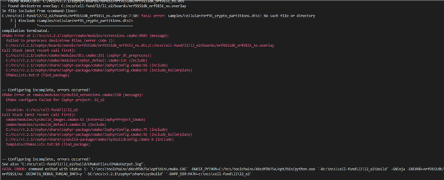

I'm stuck at the build step from teh IoT fundamentals course as when I try to build I get the next error:
It seems that the build needs two (samples/cellular/nrf91_crypto_partitions.dtsi or the .dtsi workaround files) which aren't on the dts folder. I've checked the folder and to my surprise the folder does not contain the sub-folders specified.
I've tried to solve this problem with the AI assistant but the solutions were unsuccessful.
Regards.
    I think you have pulled the latest course from GitHub. This latest version is for NCS v3.4.0. But you are building it with NCS v3.2.1.
    You can either download NCS v3.4.0 though the VS Code extension, or download the correct branch (tagged v3.2.0) on GitHub (link) which I believe should work with v3.2.1.
    After matching the project and the SDK version, you should be able to successfully build the application.
    Simon
