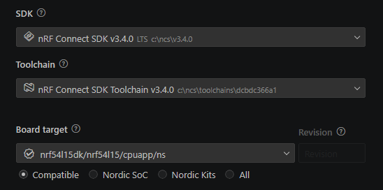

NCS v3.4.0, peripheral_uart example, double bytes Windows, UTF-8 issue
NCS v3.4.0
BLE peripheral_uart example
nrf54l15 DK with ns config
in the Chinese (double bytes) Windows, need to add encoding="utf-8" in tfm_parse_manifest_list.py to avoid the python parse error.
