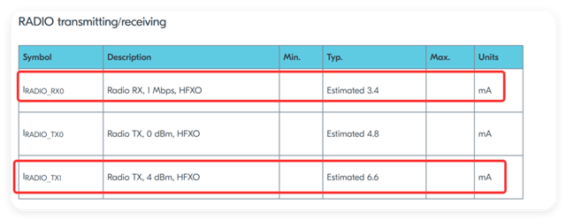

At TX CW, we measured a current of 7.85mA, and at RX, the current is 4.87mA.
Your datasheet states that TX CW at 4dBm should be 6.6mA, and RX current should be 3.4mA.
How can we make our module's current closer to these values?
