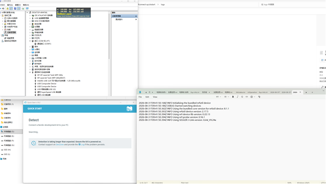

    Hello, I'm also encountering the same problem. I've plugged the NRF52840 dongle into my computer's USB port, but there's still no response. My Device Manager doesn't show any devices listed. I've already installed J-Link 9.24.
