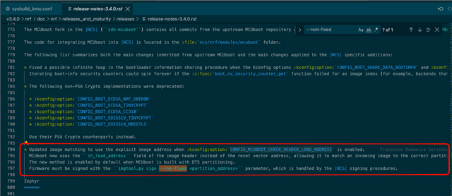

NCS 3.4.0 now encrypts the controller firmware (when encryption key specified) and sets --rom-fixed to the appropriate slot address on network core, which populates the load address of the MCUboot header.
Setting the load address causes issues with a prior bug in the 3.1.0 SDK, which was corrected by commit 8d3b38e224835f1a96c5567104b19d6383d75c6f "modules: mcuboot: hooks: nrf53_hooks: Fix invalid offset". However, the old bootloader has the bug, and that is what is flashed to my fielded devices. So the fw_info search now fails with the new images.
Assuming load address is corrected for, the firmware is now also encrypted, so the search for fw_info also fails for that reason, because the data is now encrypted.
I was able to patch b0_mcuboot_signing.cmake to create another signed bin after the build which is not encrypted and has rom fixed set to zero. It appears to be accepted by both the 3.1.0 and 3.4.0 bootloaders. I think that is probably what I'll have to go with for already fielded bootloaders.

    The signed unencrypted version may not be included in the application .zip package, but it should be included in the build output (zephyr.signed.encrypted.bin vs. zephyr.signed.bin), or is that not the case? It also looks like you may be able to avoid removing the --rom-fixed if you instead disable the CONFIG_MCUBOOT_CHECK_HEADER_LOAD_ADDRESS Kconfig option in your v3.4.0 bootloader.

    With old bootloader, network core image needs to be unencrypted and zeroed load address. When new bootloader, network core image just needs to be unencrypted. Problem is that SDK 3.4.0 doesn't generate unencrypted image by default as far as I can tell, only signed_by_mcuboot_and_b0_hci_ipc.bin, which is encrypted. So network core updates are broken in the SDK as it currently exists if CONFIG_NRF53_MULTI_IMAGE_UPDATE and CONFIG_PCD_READ_NETCORE_APP_VERSION are enabled.

  • I do not see any configurations you have missed. If the --fixed_room argument had been passed conditionally in b0_mcuboot_signing.cmake based on whether CONFIG_MCUBOOT_CHECK_HEADER_LOAD_ADDRESS was enabled, then it looks like you could have kept backwards compatibility by simply disabling it in Kconfig. Either way, I will create a bug report in our internal bug tracker to allow our bootloader team to review this. I will update this thread with any feedback I get.
