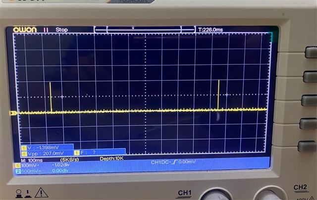

Zigbee Sleepy End Device (SED) CPU wakes up frequently, approximately once every second
My device uses the nRF52840. I migrated my Zigbee application from nRF Connect SDK v2.5.1 to the Zigbee R23 add-on v1.4.0.
After migrating to the R23 add-on, I noticed that once the device has successfully joined the Zigbee network, the CPU wakes up frequently—approximately once every second. It only wakes up briefly; this wake-up is not caused by the radio being enabled to poll for data.
My application works normally with nRF Connect SDK v2.5.1, and I did not observe this behavior with that version.
What could be causing this periodic CPU wake-up in the Zigbee R23 add-on v1.4.0? Could it be caused by an incorrect configuration option?
I have attached my prj.conf, ZigbeeStart function for reference.
