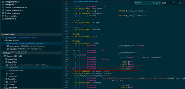

When removing the firmware loader partition, the application does not boot, and from comparing .elf files, DTS is starting the application at 0x6000 instead of 0x6800.
