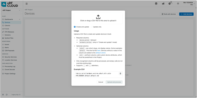

1,Please tell me how to register devices on nRFCloud.
First, I’d like to register the following two devices:
・nRF54L-DK
・Thingy 91X
nRF54L-DK
Is the procedure shown in the screenshot below correct?

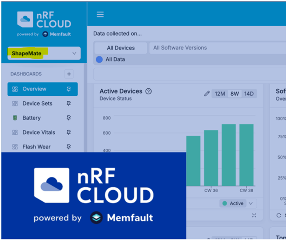

2,Also, what is “Shape Mate,” which is mentioned in the nRFCloud documentation?

  • Hello Riki Yoshida,
    For the nRF54L-dk, I think the CSV method you have mentioned is correct. I will confirm about this internally with our cloud team and see if there is a documentation for this process.
    If this image was given in the documentation, then I think it might be a name given to an example project they have used in the documentation. But just to confirm, which documentation was this given in?

    Just an update on your first question from our team. For nRF54L, you can take a look at the following guide. The nRF54L device doesn't have to be pre-registered:
    Nordic Bluetooth Quickstart (nRF52/nRF53/nRF54 Series) | Memfault Docs
    An alternative is to flash a pre-built image:
    Release v1.0.1 · nrfconnect/quickstart-bluetooth · GitHub
    The project key can be configured before running the mobile app. See the following:
    GitHub - nrfconnect/quickstart-bluetooth: nRF Cloud Bluetooth Quick Start Sample · GitHub
