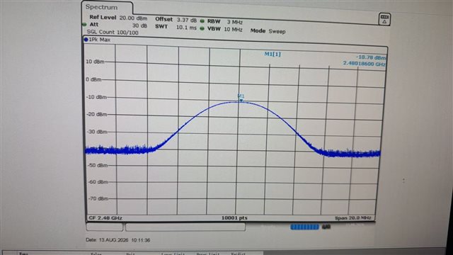

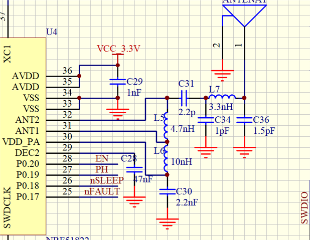

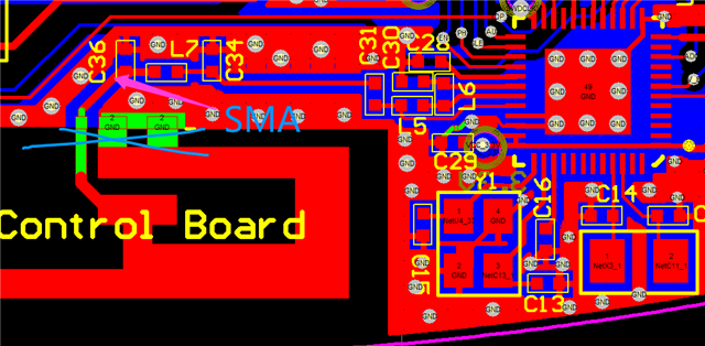

How to set tw power when using dtm example
Now my product need FCC, and I use DTM example, only changed the txd,rxd pin in firmware, the lab can use nrfconnect for desktop to enter test, but the tx power is low when use instrument to scan, I want to change the Tx power, seems the scan result not changed a bit. I've cut the PCB antenna and Welding SMA head at C36
