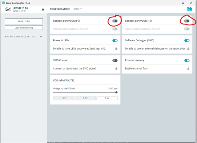

    As   says, check the back of the DK. For the case of P0.01, you can see that this is used for UART RX, and it is connected to the debugger. Since it is the nRF54L15's UART RX, this means that the debugger is pulling it high. Try disabling the UART interfaces using nRF Connect for Desktop -> Board Configurator like shown in this screenshot:
    I don't recall which one is which, but I believe it is actually VCOM1 (but try both).
    Note that this may, depending on how you have set up your logging, disable UART logging, but I think it is VCOM0 that is being used by UART logging by default.
    Edvin

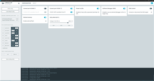

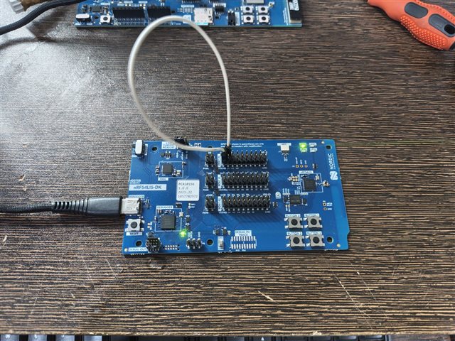

  • I started experiencing this on our custom board, that's when I checked it on the DK. I have UARTE30 disabled in my overlay.
    I disabled both VCOM0 and 1 using the board configurator. Still have the issue.
