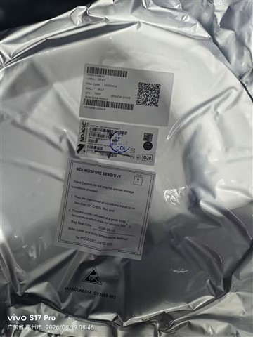

Thank you for your reply, but I have another question: was this chip manufactured in the 20th week of 2025, or is there a reason why there is a Dxx version of the chip?Silkscreen reads N52840CKAAD12520AC。
Thank you!
The one in the picture looks like they are build code D20 built in week 17 of 2026.
The text version looks like a D revision silicon from week 20 of 2025.

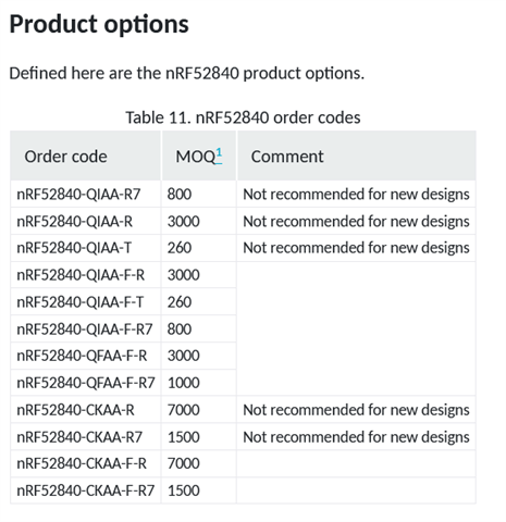

There are separate ordering codes for the nRF5240,
The ones without the -F (and that are marked "Not recommended for new design") will all be revision D, all the ones with the -F will be revision F.
Which revision you will receive will be determined by which ordering code you use, we recommend to migrate to the -F version.
