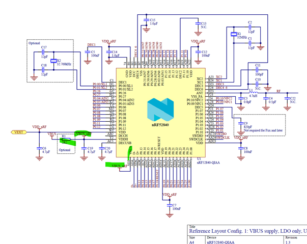

What does the 6 Ω RSOURCE,VBUS limit in the nRF52840 PS actually govern?
We are designing an nRF52840 (Ebyte E73-2G4M08S1C module) into a battery-powered wearable, USB device only, Full-Speed, sink-only Type-C with 5.1 kΩ Rd on both CC pins. We are trying to establish whether a design of ours genuinely violates a spec limit, or whether we are reading the limit too literally.

For safety reasons the module's VBUS pin is not connected directly to the connector. There is a local 5.0 V LDO between them, so the module's VBUS pin is fed from a regulated source rather than from the bus:
USB-C VBUS ── [protection] ── LDO (5.0 V) ── nRF52840 VBUS pin
Because bus VBUS is 4.75–5.5 V and the LDO is a 5.0 V part, it operates in dropout essentially all the time, where it behaves as its own R_DS(ON): 4.90 Ω typical / 10.0 Ω maximum. With board resistance that is about 5.13 Ω typ / 10.33 Ω max between the connector and the module's VBUS pin — over the 6 Ω limit at the maximum corner, before any cable.

    That is referring to DC resistance. So as your calculations say you are still safe enough with the mentioned current levels. I would recommend to move on with current LDO you have.
    If you check Nordic reference designs, in one them that VDDH and VBUS are connected together , there is even a 2.2 Ohm resistor intentionally added to the VBUS path, together with a 4.7 uF cap to improve transient fluctuations.
