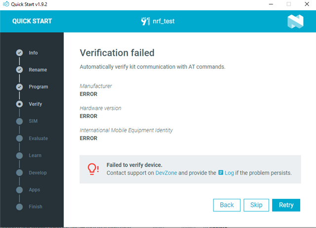

Not being able to install Serial LTE Modem through Quickstart app. Verification error.
I am trying to configure the NRF9151-DK, but when opening Quickstart app it cannot verify the board.
Here's the log.

2026-08-20T21:04:11.016Z INFO Opened port with options: {"path":"COM15","baudRate":115200}
2026-08-20T21:04:15.064Z INFO Closed port: COM15
2026-08-20T21:05:27.067Z DEBUG Changed step: Verify
2026-08-20T21:05:30.082Z INFO Opened port with options: {"path":"COM15","baudRate":115200}
2026-08-20T21:05:32.086Z ERROR Timed out
2026-08-20T21:05:32.090Z INFO Closed port: COM15
I've been working with exact same boards, also through VS Code, so this seems very unusual.
I tried recovering with nrfjprog --recover -f nrf91 but it doesn't help.
Thankful in advance!
