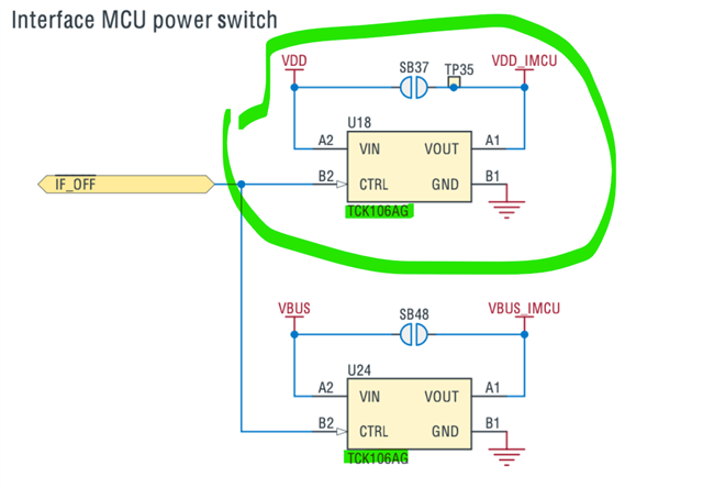

Digging into the schematic (V3.0.2 here), I noticed the IF_OFF net controls the switch U24 that connects incoming USB power (~5v) to VBUS_IMCU (VBUS / A5 pin on NRF5340) on the interface MCU. The IMCU needs 5v on this pin.
If the default / NRF_only switch is in the default position, IF_OFF should be high if USB_DETECT is high. I verified USB_DETECT was high on my board. I'm pretty sure IF_OFF was 3.01v, as measured at the circled pin here on SW6:
Measuring both sides of SB48 showed a delta: one side measures 3.5V, and the other measures 5.2V. Clearly the switch is not closed although I believe in this state it should be.
Solution:
The solution was then to short SB48. Doing so resulted in totally normal behavior as before.
BONUS SOLUTION:
Without digging through the schematic for my V2.1.0 DK, I found SB48 visually and tried shorting it. Again, the board worked totally normally after that. I'm assuming the architecture is similar even though it does not use a NRF5340 as the IMCU.
Diagnosis:
Given that IF_OFF was high, and based on the DS for TCK106AG, VIN/VOUT should be connected when CTRL is HIGH, I believe the switch U24 simply failed for some reason.
