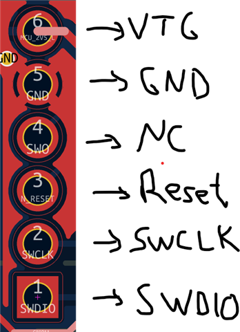

Hi everyone,
I am trying to use a PCA10040 (nRF52 DK) as an external debugger to program a custom nRF52832 target board, but I keep running into J-Link backend errors (-256 and -102).
Interestingly, my board's interface/debugger chip is an onboard nRF5340 chip, and the J-Link logs show it initializing with the J-Link OB-nRF5340-NordicSemi firmware.
To ensure proper power and signal integrity, we verified that the target VTG is connected directly to the board's onboard VDD rail (sitting stable at 3V), and all ground paths are securely tied together. Additionally, a full continuity test was performed from the physical chip pads to the debug header to guarantee there are no broken traces or cold solder joints on the SWDCLK, SWDIO, and reset lines
Hardware Setup & Verification:
  • Debugger: PCA10040 (nRF52 DK)
  • Target: Custom nRF52832 board
  • Power & Logic Checked:
    • Target VTG is stable at 3V.
    • GND lines are firmly connected.
    • nRF Reset pin is pulled up / stable at 3V.
    • SWDCLK and SWDIO are correctly mapped.
What We Have Tried:
  1. Swapped SWDIO/SWDCLK pins to double-check against accidental reversals.
  2. Verified that the P19/P20 select pin voltage states are active.
  3. Lowered SWD clock frequencies.
  4. Attempted recovery using both nrfutil device recover and nrfjprog -f nrf52 --recover.

Questions:
  1. When using a PCA10040 kit equipped with the nRF5340-based interface MCU to debug an external nRF52832 target, does the cross-family CoreSight mapping require a specific configuration or command line override?
  2. What could be causing the JLINK_CORESIGHT_WriteAPDPReg function to return -1 during the target connection handshake?
Any guidance would be greatly appreciated!
  • There are several more lines needed to program external targets, have you added all these? You can see which ones in the DK HW user guide. All lines listed are required, not only the 2 SWD lines.
  •   Yes i did and specified it in my question. VTG, SWDIO, SWCLK, RESET, GND , VDD. Also i tried both - external supply for custom board and supply from nrf52 dk VDD.
  • İ verified that if i left VTG unconnected onboard nrf52832 flashed otherwise P19 or P20 selected. I left unconnected p19 and suspect about it. Somehow P19 can be selected? I use P20 connector
    The errors you are seeing points towards a incorrect connection to the external board.
    krf said:
    DEC3 pin is at 3V
    DEC2 is at 1.26V
    DEC4 is at 1.26V
    DEC1 is at 1.09V
    These are all within the expected area, assuming VDD=3.0V.
    Q1: Can you please share a picture on how you've setup the connection from DK to custom board?
    Q2: Does this occur on more than one board?
    Håkon
    Q1: When i supplied my custom board with 3V, i connect this pins to P20 of DK. I didn't want to send picture because i don't believe it would be observable (bunch of jumpers there are...). Here is the pins of custom board programming header: Vsupply, GND, SWO, N_RESET, SWCLK, SWDIO. Do not  be stuck on for MCU_2V5_L label whole mcu supply seperated by headers and those whole tests made with seperated supply line!
    Q2: I didn't yet try it with another board but i will try it.
    Also i want to mention it P19 select pin is at 3V when i left it float. Is it problem?
    Note: With this board there was 1uF cap on reset line which makes reset line unstable with first tryings ( It was stall at different voltages like 1.25V, 0.78V etc.) . After removing cap now reset line is stable at 3V but i suspect it if somehow it might be broke chip. Is it possible?
