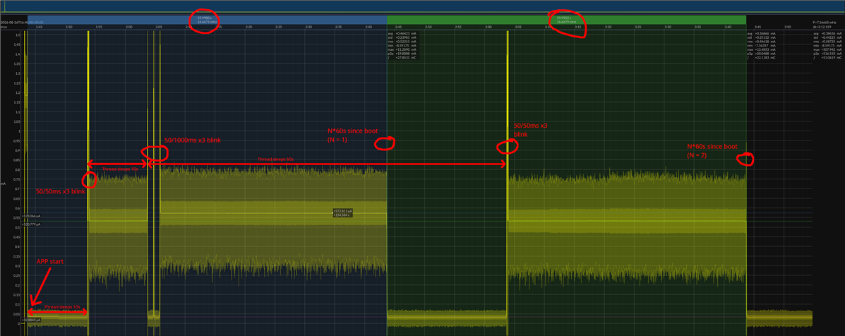

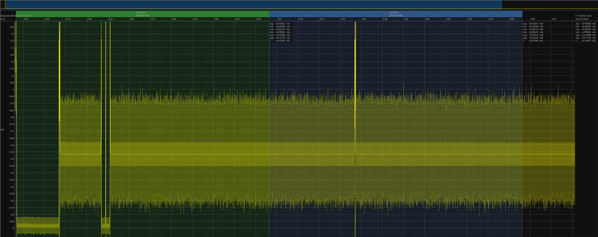

I've noticed weird behavior in the software timer scheduling. I my case, there is one timer handling LED blinking. It is used in single shot mode and rescheduled to time the lit up time and blank time. Once the blinking sequence is finished, the timer is not rescheduled and SoC keeps consuming way too much power (~500 uA).
There is something running with 60 s period since the app start, that resolves this increased power consumption.
If I time the LED blinking by sleeping the thread, the issue is not present - it is specific to software timer scheduling and power management tied to it.
Steps to reproduce
  1. Have a minimal application with power management enabled and SoC current measurement.
  2. make the main task sleep for some duration
  3. observer low power consumption (OK)
  4. Start software times with expiration before 60 s of uptime
  5. Observe power consumption after the timer expires -> elevated
  6. Wait for nearest future N*60 s uptime
  7. Observer power consumption drop to expected low power sleep levels

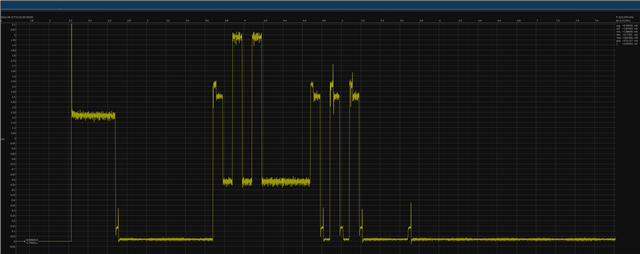

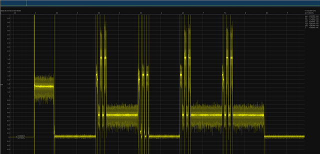

After disabling bluetooth and some other stuff, to make the test minimal, the 60 s "recovery tick" does not occur anymore and power consumption never drops back to expected levels. It still drops during 1s LED off times, when the timer runs.

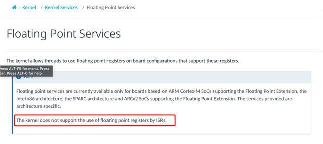

  • So this was interesting adventure, it looks like (some?) float operations in the timer expiry callback cause increased power draw.
    I've also attached disassembly of each handler.

  • Thanks for sharing the code and config. This is an interesting find. I was able to reproduce this on my end as well, and it seems like the elevated sleep current may potentially be related to the FPU. I assume you are also not seeing the issue if you don't enable CONFIG_FPU in your project config?
    Not related to this specific issue, but the Zephyr also documentation states that use of FPU instructions inside interrupts is not supported:
    https://nrfconnectdocs.nordicsemi.com/ncs/latest/zephyr/kernel/services/other/float.html
    I will continue to investigate this on my end.
  • Not related to this specific issue, but the Zephyr also documentation states that use of FPU instructions inside interrupts is not supported:
    This is the most important info for me! I completely missed this fact in the docs.
