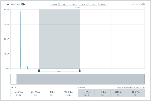

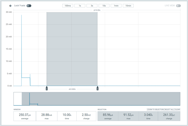

The problem occurs when I measure the idle current with a PPK2 between the MCU and the PMIC.
I got 238uA on my board, while on an nRF54L15 DK board, that value is just 4uA.
In reality, if I disconnect the SWD cable, that value drops to 87uA, but it's still much higher than 4uA.
Those values remain even if I power the MCU directly at 3V from the PPK2, rather than using the PMIC.

  • Dear Kenneth
    Here are the files you asked for:
    Auto-detected SVD file: nrf54l05_application.svd
    WARNING: Reading all 92 peripherals may take a long time!
    Press Ctrl+C to abort...
    # NOTE: Registers with 0x00000000 or 0xFFFFFFFF are hidden by default.
    # Use --show_00 or --show_ff to display them.

    Here are the idle currents measured by the PPK2 in both cases:
    Many thanks for your help!
    Helio
