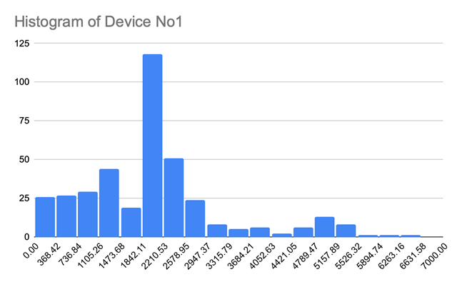

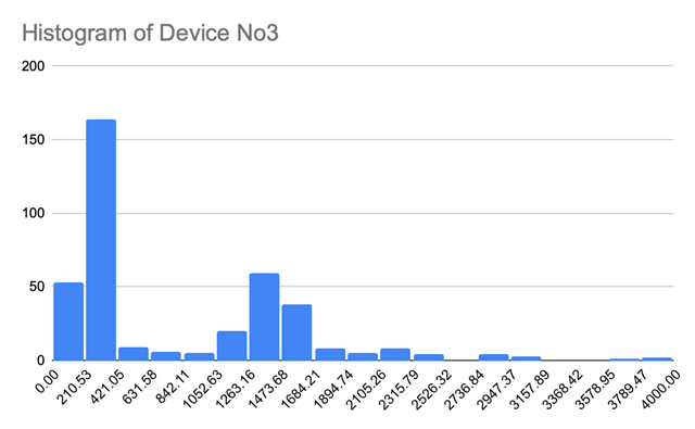

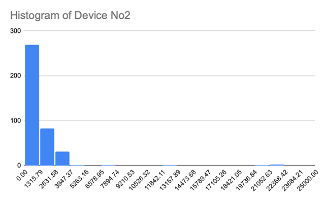

    2) Here is a histogram of the ping times for two devices. This is just an interesting observation.
    The two devices are located at the same spot and have similar signal strength. Both are switching between two cells. The histogram shows the results of around 350 random pings. Time is in milliseconds.
    For Device No. 1, the maximum ping time was 7 seconds, while for Device No. 2 it was 25 seconds + it is all over the place with timeout of 23s, 22s, 21s, 19s etc.
    The only difference between these two devices is the MQTT keepalive time: for Device No. 1, it is 120 seconds, while for Device No. 2, it is 30 seconds.
    Therefore, Device No. 2 has ping times of up to around 1.3 seconds more frequently, as the device is in the RRC connected state more often.
    To rule out the possibility that this is related to the MQTT keepalive time, here is also a histogram for Device No. 3, which is in a different location, camped on a single tower, and also has a 30-second MQTT keepalive.
    I guess that when doing these pings you are sending every ping with more than 30 seconds intervals in between the pings.
    I think that checks out perfectly with the 2.54 seconds of paging that I'm seeing in the trace as the average time added to receive a message should be around half of the paging time.
