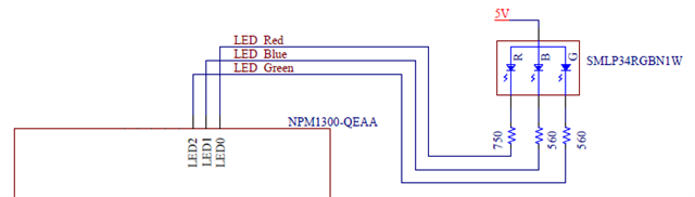

I've applied 5V to the anode of the LED, and the cathode is connected to the LED0 terminal of the nPM1300 via a resistor.
I've set the registers in I2C as follows, but the LED doesn't light up.
0x0A00 (LEDDRV0MODESEL): 2 (HOST)
0x0A03 (LEDDRV0SET): 1 (SET)
Is my procedure incorrect?
The circuit diagram is as follows:
