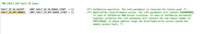

<error> app: Fault identifier:  0x1001
<error> app: Program counter:   0x38512
<error> app: Fault information: 0x1
