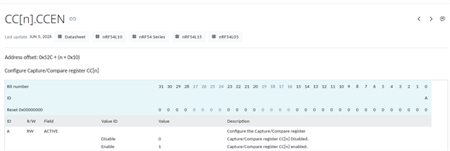

CC[6].CCEN 0 the compare fired
EVENTS_COMPARE[6] 0 its event is nevertheless gone
INTEN2 bit 6 1 the interrupt was enabled the whole time

CCEN is the reading the diagnosis rests on. Its behaviour is not described in the nRF54L15 Product Specification (see question 5), so phase A0 of the reproducer measures it, on a compare channel: it writes a CC and reads CCEN, then waits for the compare and reads CCEN and EVENTS_COMPARE again. On the DK, CCEN == 1 after the write, and CCEN == 0 with EVENTS_COMPARE == 1 after the compare fires. CCEN == 0 with EVENTS_COMPARE == 0 therefore means a fired-then-destroyed compare — we cannot construct another sequence that produces that pair — and the eliminations below that depend on it stand.

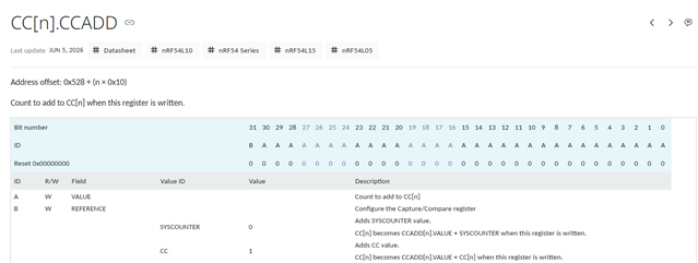

CC written into the past, or lost in the CCL -> CCH write window — ruled out by the CCEN reading
Both are candidate mechanisms by which the compare might never fire at all, and both are excluded by CC[6].CCEN = 0: a compare that never matched would leave CCEN at 1 (the CCEN state machine as measured by phase A0). The past-CC candidate is doubly excluded: A0 also shows the hardware raises EVENTS_COMPARE for a CC written into the past, so that is not a way for a compare to go missing.

    ''The EVENTS_COMPARE[n] event can be generated by writing the compare values to the corresponding CC[n].CCL and CC[n].CCH registers. When a channel compare functionality is enabled and SYSCOUNTER is equal or greater than that CC value EVENTS_COMPARE[n] will be generated. Writes to CC[n].CCL disable the corresponding compare channel and writes to CC[n].CCH enable it. So CC[n].CCL must be written first''
    Channel compare functionality can be read by CC[n].CCEN register.
    For CCCAD, it is written in the documentation
    ''The compare value for CC[n] can also be updated by adding a fixed value provided at CC[n].CCADD.VALUE. Based on the CC[n].CCADD.REFERENCE configuration, either the current CC value or the current SYSCOUNTER value is added to the CC[n].CCADD.VALUE to configure the new compare value. If the CC[n] overflows after writing to CC[n].CCADD.VALUE, then EVENTS_COMPARE[n] is generated immediately. Writing to CC[n].CCADD enables the corresponding compare channel.
    Writes to CC[n].CCADD are ignored when the SYSCOUNTER is in sleep state.''
  • Hello and thank you for your in-depth response. We had been looking in the GRTC register tables and did not cross-check with the syscounter section.
    Reading on in the same subsection also answers the CCEN question, in the paragraphs immediately after the part you quoted. From "Compare and Capture (CC)" under section 8.10.2 SYSCOUNTER (Datasheet v1.0, 4503_018, page 297):
    Each channel compare functionality, except for the first channel when operating in periodic mode, operates in one-shot mode. When operating in one-shot mode, CC[n].CCEN.ACTIVE is cleared automatically following a compare event.
    Moreover, a compare channel is automatically disabled when triggering TASKS_CAPTURE[n].
    The EVENTS_COMPARE[n] event is generated immediately if the configured compare value at CC[n] is less than the current SYSCOUNTER value.
    That lets us restate the diagnosis in the documentation's own terms:
    • A generated EVENTS_COMPARE[6] clears CC[6].CCEN.ACTIVE. The three other ways to clear it are all unreachable here. A CC[6].CCL write without its CCH is not expressible — the two are adjacent statements in nrf_grtc_sys_counter_cc_set(). Nothing in the image triggers TASKS_CAPTURE[6]. And the nrfx entry points that write CCEN directly — cc_channel_prepare(), nrfx_grtc_syscounter_cc_disable(), nrfx_grtc_uninit() — reach channel 6 only at init, or through callers this build does not compile in; the report excludes them one by one under "What we ruled out".
    • On the halted device we captured CC[6].CCEN = 0 with EVENTS_COMPARE[6] = 0, the channel interrupt still enabled, and the SYSCOUNTER far past CC[6].
    • By the documented behaviour that means the hardware generated the compare event and software then destroyed it. A compare that never matched would have left CCEN at 1.
    The last sentence of the quote also disposes of the two alternatives we had listed — a CC written into the past, and a compare lost in the brief CCL -> CCH window while the channel is disabled. Neither can strand the channel, because the event is due as soon as the channel is enabled.
