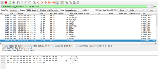

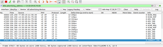

Made nrf52832-DK as a sniffer, using nrf sniffer for bluetooth le 4.1.1 and wireshark version 4.0.7. Now iwant to sniff NRF54L15 BLE device/Peripheral which is connected to central  using nrf connect app..
Now issues iare as
1. It detects advertisments successfully but sometimes it doesnot gives log entry of CONNECT_IND and remians in ADV_IND,SCAN_REQ and SCAN_RESP,despite device is connected with central
2. If it detects CONNECT_IND thenafter it doesnot log any communication event happening between device and central.

    In order to follow a connection you need to select the advertising device in the dropdown in Wirehark in the device list before the CONNECT_IND is sent. Do you do that? Note that even then the sniffer may loose the packet, and then you need to try again (disconnect and establish a new connection and see if the sniffer picks it up).

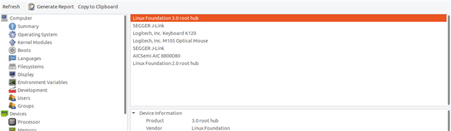

  • I see. I am not able to explain this, but the nRF52832 having no USB is a bit limited as it depends on UART and USB-CDC. In order to limit the potential proglems introduced by that, I suggest that you 1) Disable the mass storage device on the debugger (using the MSDDisable command as described here). It is also worth making sure that the J-Link firmware on the DK is up to date, which you can do with J-Link Configurator.
    I am sorry I did not spot this before in your previous screenshot, but you are filtering on advertisign address using normal wirehark filtering. So you will not see this in a connection. You need to select the device from the Device list dropdown where you currently have selevted "All advertising devices". That is a requierment in order to follow and sniff a connection.
    Thanks for Highlighting.
    It worked, It was observed that after changing firmware of segger Jlink. it helped.
